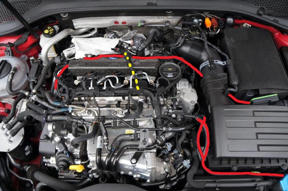

Rick,
did you not look at the photo we sent showing where and how to route the cables?

Yes I saw it but but then realised I would have to undo stuff again to thread it under the airbox plumbing.
Had already seated the cables and they seemed safe away from any hot parts so I didn't think it would be an issue. Is it?
I've tried to keep it away from any hot parts.
no need to remove anything Rick, I've had 3 customers fall foul of melted looms hence the reason why we send the recommend route..

Andrew just watch the recommended route as I caught my loom at the back left next to the polystyrene block.
I can only presume it caught on the engine cover.
The plastic shroud is dented in. Is there a way I can check the leads are ok?

Ok, i'll see about changing it round. :smiley:
Is the #2 cable routed to the front of the airbox and then doubled back on itself under the pipework to the control unit? I'm not 100% looking at the pic.
What are those yellow dots on the pic?

The loom goes under those yellow dots. You need to unclip it first.

Now i'm totally confused.
This is how i'm understanding your pic. Hope mine makes sense.
