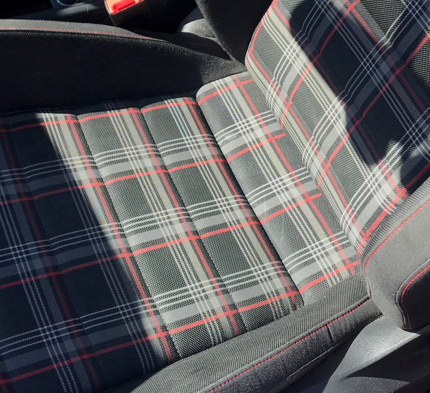

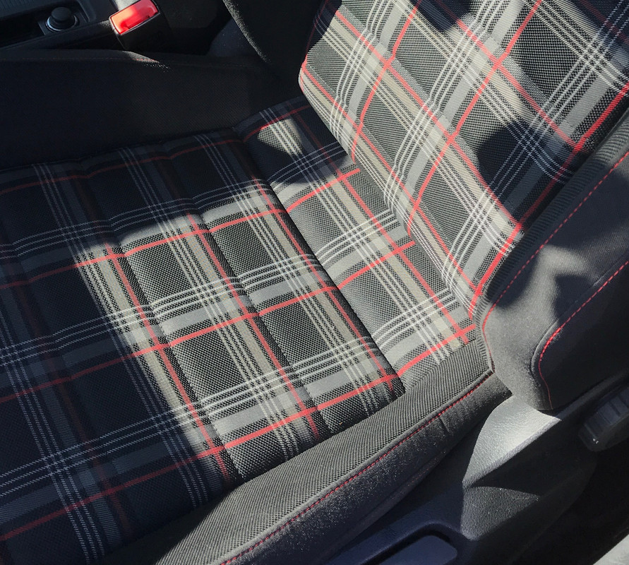

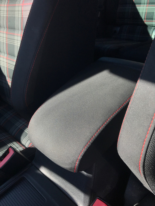

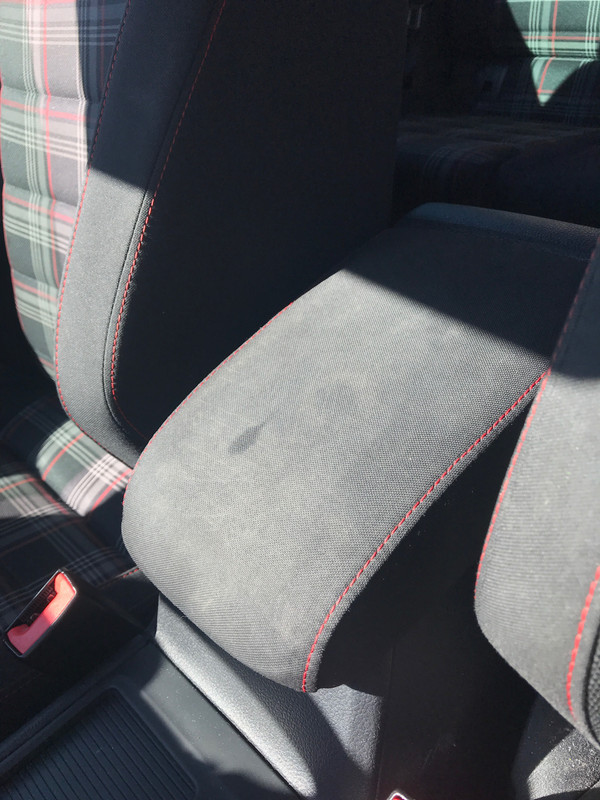

Noticed some white marks on my seats the other week like mould. Weird as I've never seen it appear in the car like that before. So bought some of this to try. Seems to have worked but takes a hell of a lot of elbow grease to so all the seats and upholstery. Spray on and agitate with a slightly wet sponge or cloth.  Has a decent smell to it also. Not sure if a little soap and water would've done the same job though.
Can you notice a difference?

Check the car for the usual areas of water ingress, and turn air recirc on when you leave the car for the night, you don't want mould spores in the car.  :smiley:
If the dirt marks come back when dry, you just need to repeat but also need to take a spray bottle of just water and spray the entire seat panel eg entire armrest, entire seat base evenly so it dries evenly so you get no marks.

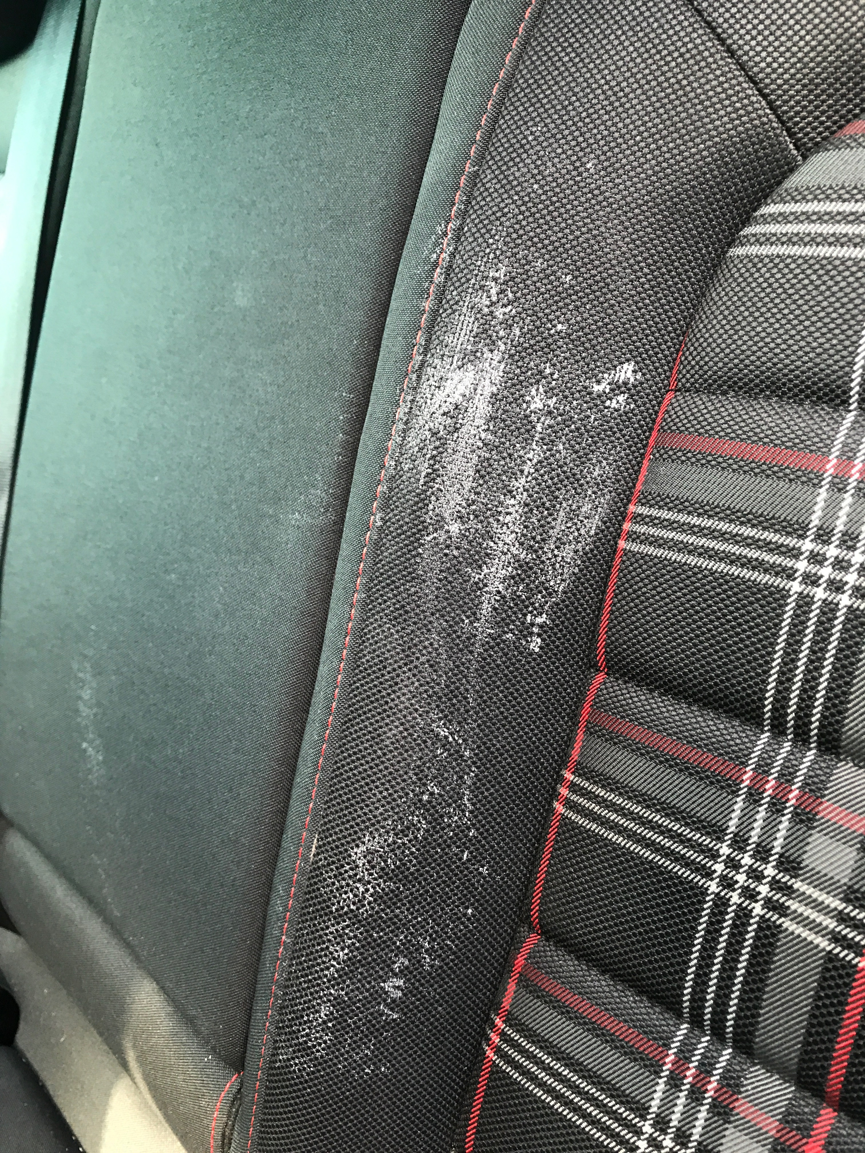

I know behind the speakers is apparently one place, do you know the others?. Oh I like that air recirculation tip, certainly didn't think of that one!. Will give it a try as I only really drive it on the weekends so should be good. THIS is what appeared. Never seen it before and seemingly appeared overnight a couple of months back. I scrubbed it off and it hasn't come back since
Haven't noticed any spots come back yet so I think I certainly put my back into it haha. Arm was aching after!. Wish I would've used a spray bottle, would've made it a lot easier

To me that doesn't look like mould, looks more like chalk did you set something in the seat? Car mould is green with a white edge.

I know right, it's so weird. It was on the front passenger seat and on the back seats (I never have anyone or anything on the back seats). If you search 'White mould car seats' on Google it looks similar. It's never come back and I've never had it in any of my other cars

The link that @Lordie posted in reply #11296 of this thread to the picture below looks like the inboard side of the rear nearside seat, so that area of the seat shouldn’t get wet from water droplets when opening the doors.
@Lordie; if you don’t carry rear seat passengers or any loads on the back seat, have you checked your headlining for water staining above the rear seat that had these white marks on? I’m wondering if the rubber gasket between the roof panel and aerial might have failed, allowing water in, saturating the roof lining and then dripping onto (and soaking) the rear seat backrest, although if it happened only once that’s probably not the cause.
With the staining on the front centre armrest; is it possible that a front seat passenger or driver could’ve had something damp on their sleeve that transferred to the armrest?
Condensation on the inside of the windscreen during the colder months may be a consequence of when the ambient air temperature drops below the dew point, causing moisture to form. However, if you’re getting ice on the inside of the screen and the car regularly steams up inside, ignoring the staining on the seats, these signs might be an indication of a separate water ingress problem. Check all the usual potential sources of water ingress and telltale signs;
