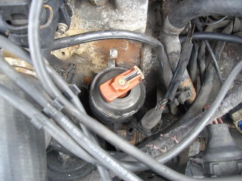

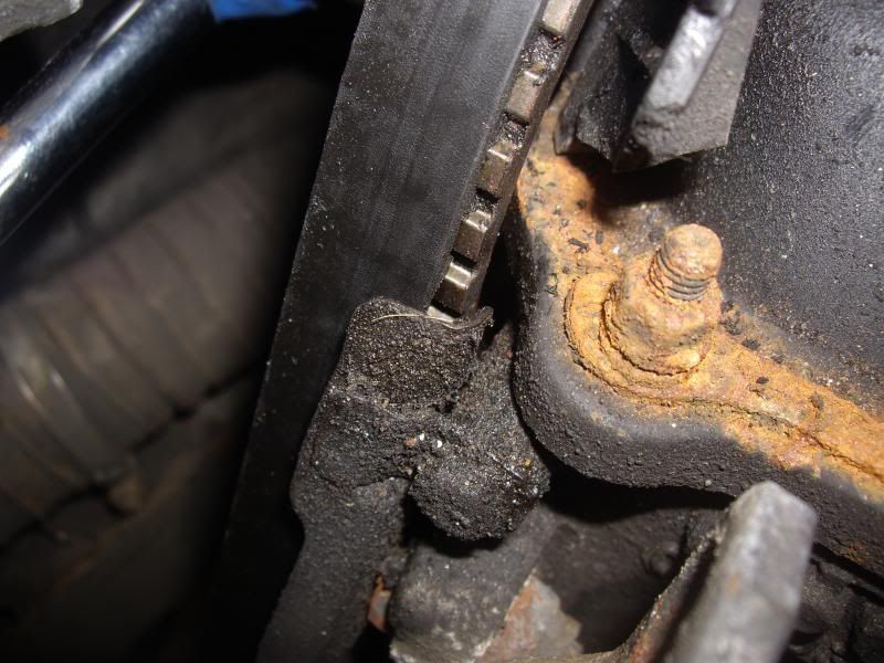

Have replaced any dodgy earth cables and ignition lights are on. Engine turns over but stops - seems like the timing may be out or that the leads or not in the correct order.
I have found the mark on the cam sprocket that shows tdc on cylinder one and the rotor arm points to 2 o'clock as shown in pictures. Still wont start though.
you can just see the indent on the cog.
I am right in assuming that from plug one its 1 3 4 2 in a clock wise direction?

Just swap leads around. Eventually you ll find where number 1 is

yeah it's 1342 firing order and rotor arm wants to be pointing at the line marked in the dizzy body.
if it's turning then stopping that sounds more like a flat battery, does it just do like half n turn n stop and lights go off?

1-3-4-2 in a clockwise position? Just checking..
