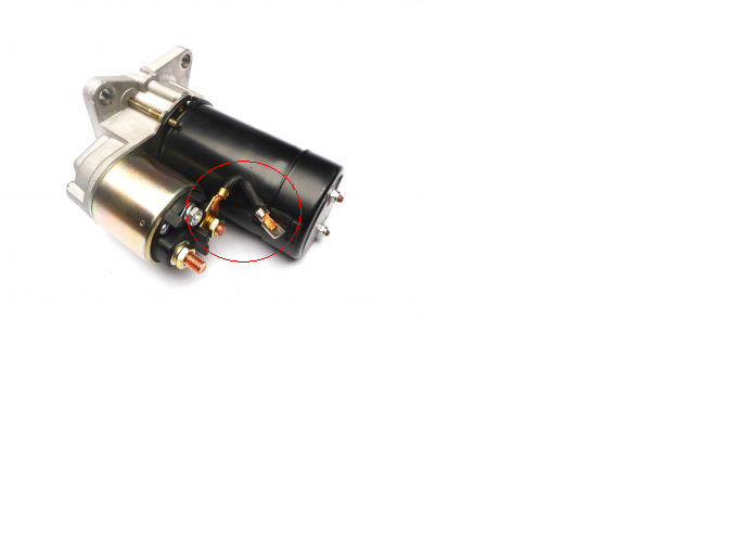

Took the starter off, to get it re-cond. The "Starter Man" as we call him. looked at it and said the starter will be fine, your missing this "circled in the pic" below. He told me what its called but i forgot which is why i had to get a pic and post it up. So if any of you guys are having problems. You now know where to look  :smiley:
Its must have been brittle and snapped off.
