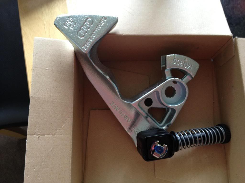

Ok, so Picked up my new OEM TT/S3 short shifter (part number : 8J0711046E ) from Audi.

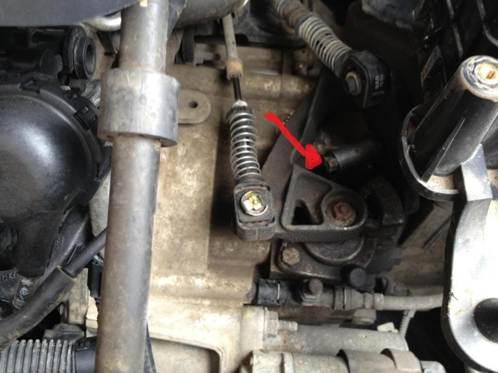

The only thing is that the install for the MK6 is slightly different, the second clip he removes is not a metal one. Its a white plastic one, and you have to be very careful to to break it as i have read a few heavy handed Americans have  :grin:
So here is the new one.

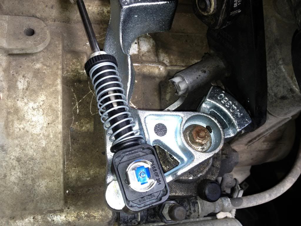

This is the clip you have to be careful of, lift it gently from both side, DO NOT try pry it sideways !!!
