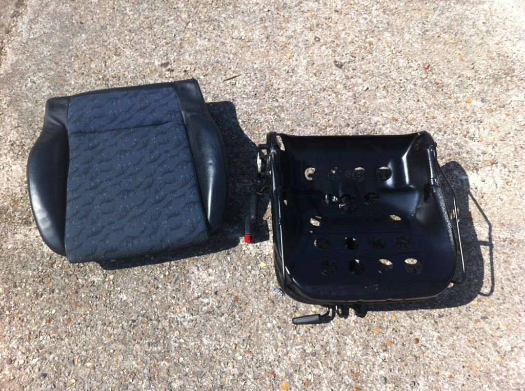

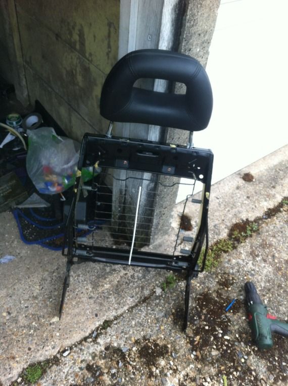

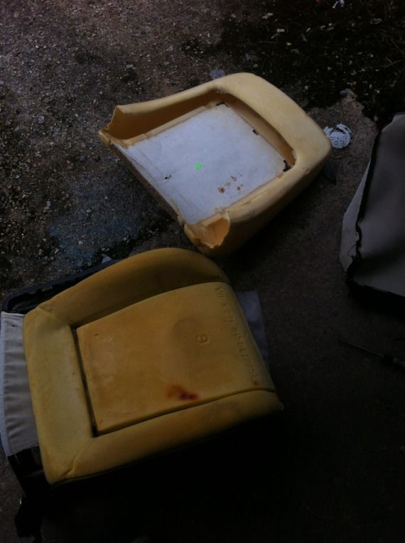

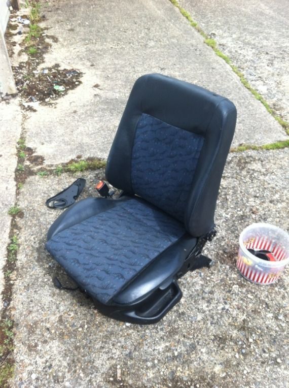

Ok have almost fitted the Toledo interior.
Rear seats bolted strait in.
After researching on the web found out the front seats have mk2 setup.
So took them apart to use mk3 bases and Toledo back but brackets totally different  :cry:
So had to take the material and foam off both seats and swap so now the Toledo foam and cloth/leather is on the mk3 metal frames.
Wile doing this I realised the headrests pins are spaced wider apart so also had to drill the top of the metal frames for it to work.
And now finally after hours of work I have one seat done lol
Just the drivers one to do now.
Will take more pics when it stops pissing down.
Few pics I took Owen I wasn't swearing at the seats.  :grin:
Toledo foam and fabric on mk3 Frames.
