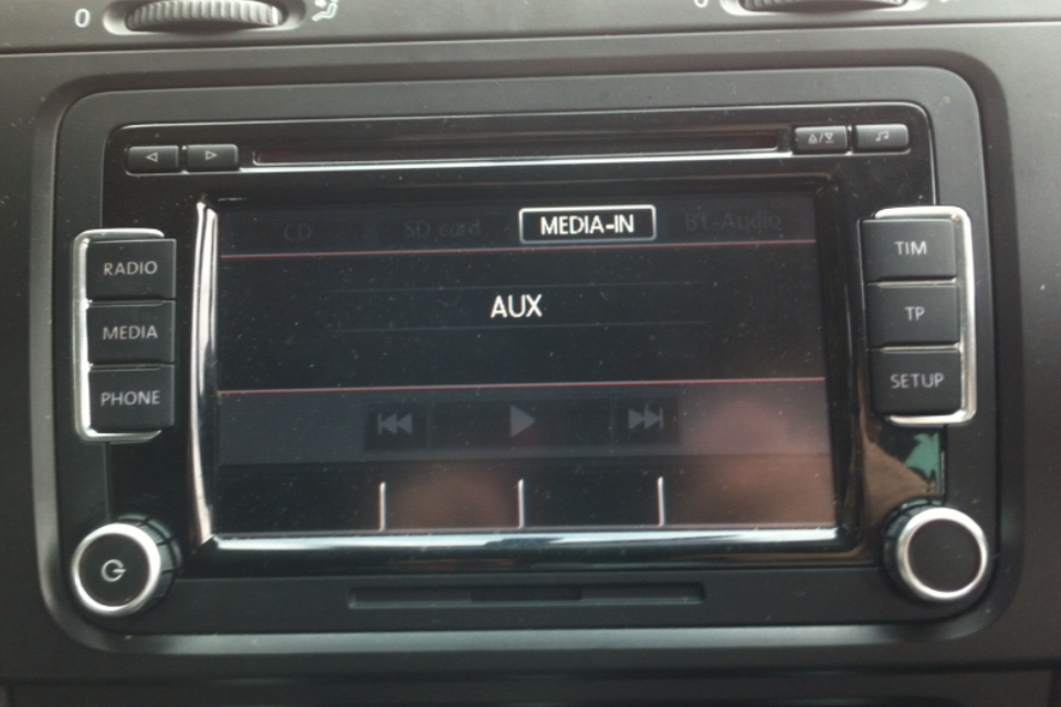

Radio Help
« Reply #14 on: 09 April 2013, 18:25 »
Does anyone know if there is a way of installing Bluetooth ( using VAG COM would be brilliant ) to this radio ... Been told its a possibility, but was just seeing if anyone on here had some experience???
http://i1279.photobucket.com/albums/y540/passant125/photo_zpsc656d09e.png
My radio ^^^^
As you can probably see on the picture (top right) theres a BT AUDIO button that I can't press! HELP!
Thanks
Tom
My radio ^^^^
Thanks
Tom
Probably cos its not got a bluetooth module.
Have a look at:
www.fiscon.co.uk
m0bridge
VW BT unit
They are plug and play but you will need to get it coded with VAG.com
You never answered if your iphone has the tracks etc listed on the head unit?!
