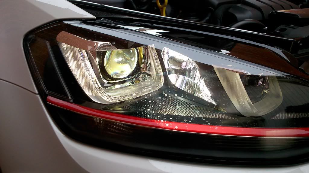

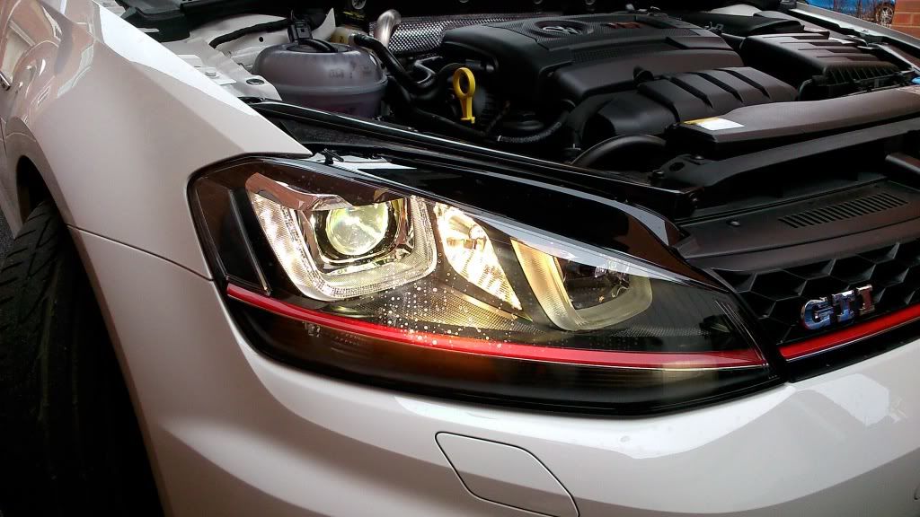

Actually it does.... The centre light between the bi-xenon and the parking led comes on below speeds of 10km/h. It's an H7 light as you can see in the picture and it is definitely active in mine as you can see in this video:
http://www.youtube.com/watch?v=MDqXqr8KLG0
The reason I've resurrected this thread is that the yellow colour of the cornering lights is annoying me compared to the white light of the xenons, so I've just ordered a set of blue H7s.

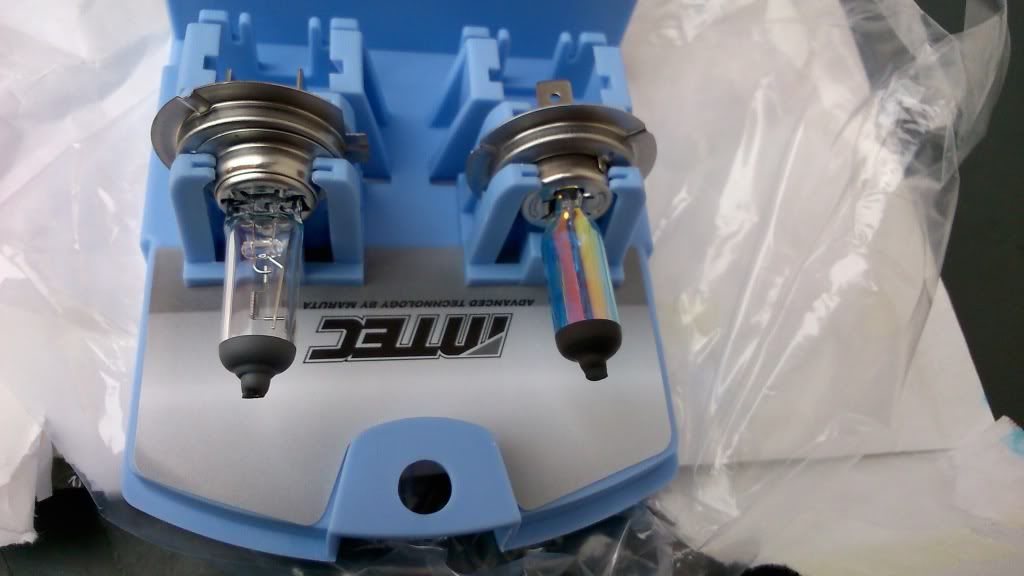

Whilst on the subject, is the H7 a horrible yellow bulb and will it need replacing with an Mtec or does it already match the xenon?
2007: Leon PD170
2010: Leon CR170
2013: Golf GTI PP
2016: A45 AMG
Offline monkeyhanger
  • Posts: 6,663
Re: GTi & GTD xenon headlights
« Reply #45 on: 05 December 2013, 07:51 »
Standard H7 is quite yellow, swapped mine out for Osram Nightbreaker plus.

Normal middle, mtec cosmos blue bottom and the bulb On the right in case anyone wants to see what it looks like
