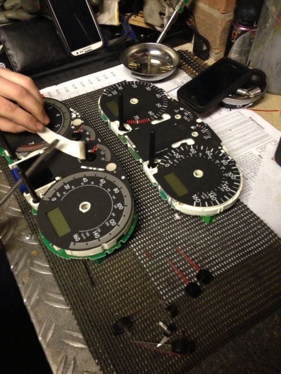

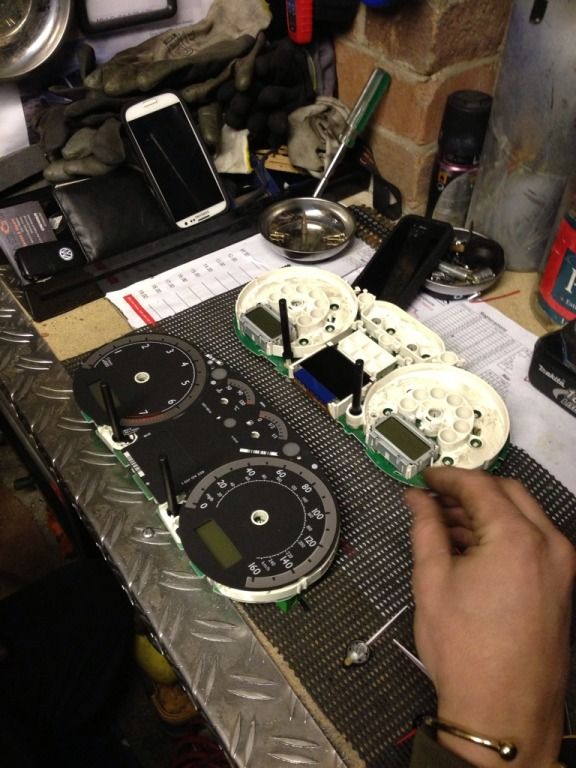

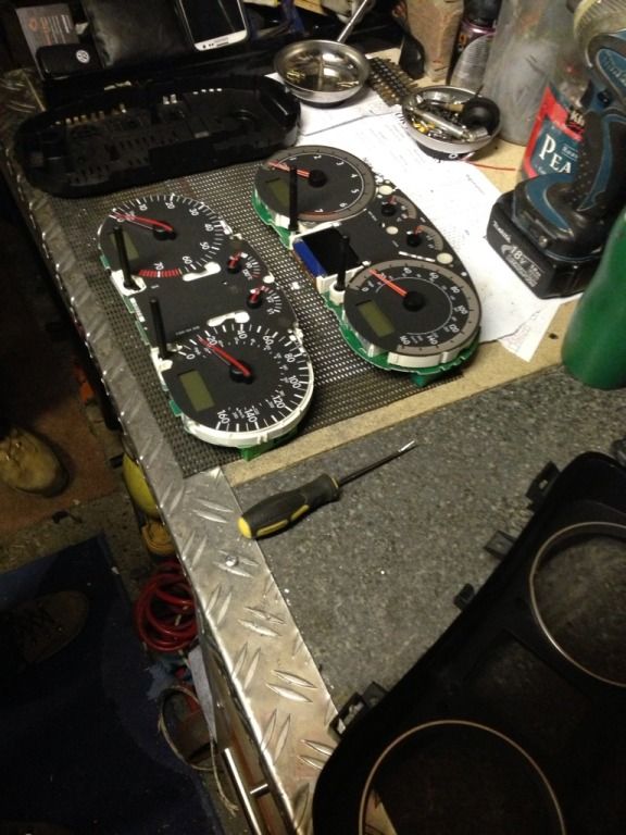

My clocks are basically the anni bits with my standard Gti guts....I made them fit  :grin:
To be honest, the anniversary needles arent all that, look at the photo below, the centre of the needles are black whereas the Gti ones are red all the way through. I swapped them, then deceided I preferred the gti ones so I changed the temp and petrol needles back but kept the main needles as the anni ones.
Its a piece of piss to do you just need to make sure when you put them back to 0 that the needles are at 0, when you turn the keys on in the car, they will recalibrate and maybe slightly off....i had to take mine apart 3 times to make sure they were spot on.
Its such an easy mod to do. If anybody has or comes across TT/r32 needles then il gladly swap my anni ones as they are the same but the middle circle on the needles is silver instead of boring black.....

(With the anni rev/speedo needles and the gti fuel/temp needles)

If the needles never been removed just get a flathead screwdriver and something on the end not to scratch the clocks....I used tape but a thin microfibre would be better. Just apply even upward pressure and they pop off. You do need to give it a bit of welly but not too much....hard to explain.
The Anni needles on the back are MUCH shorter then the Gti so I had to fit down the lip on the guts to make the smooth. Sounds complicated but it is actually SO easy. Might start making some up if people are interested (not on your own clocks, on some clocks then sell)
