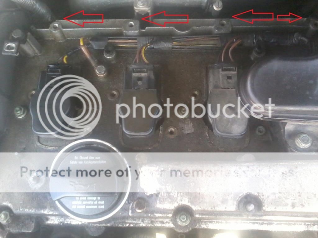

Okay was gonna do my rocker cover gasket today and the compression test when i cam across this and i have never noticed it before
Should there be bolts in those holes??? ive never had the rocker cover off and this is the first time ive noticed that.
Also my rocker cover has got insanely oil covered since i topped up the oil, its seems to be coming out of the first 2 cylinders from the drivers side wheel. Would the missing bolts cause the gasket to be less effective? also the oil that in the spark plug wells is really new as it is very amber almost as if it made it up there right after i topped it up and im now noticing constant reluctancy to rev struggles through 1000 to 2000 revs, spits splutters and backfires but no misfire codes at all. Could this all be related to anything in particular?
As for the missing bolts whats the thread diameter?
Mk4 GTi 1.8t 16" BBS Alloys, Coilovers, Full Exhaust, Catch can..... More to come - If i ever beat this 17705

« Reply #15 on: 29 March 2013, 14:54 »
Theres no bolts missing, the rocker cover is fived with the nuts on the front and back edge and the ones in between the coil backs. Those threaded holes will be for something on another model as the all carry virtually the same rocket cover. I would get a compression test done and post up the results, make usre car is upto temperature first. Worn valve stem seals will not cause a drop in compression but a worn piston ring definately will. Failing both of these it could be the oil seals in the turbo beginning to fail.

« Reply #16 on: 31 March 2013, 00:10 »
Those extra holes are for coil packs that bolt down. I have no idea which model has the bolt down packs, could be an Audi feature?
