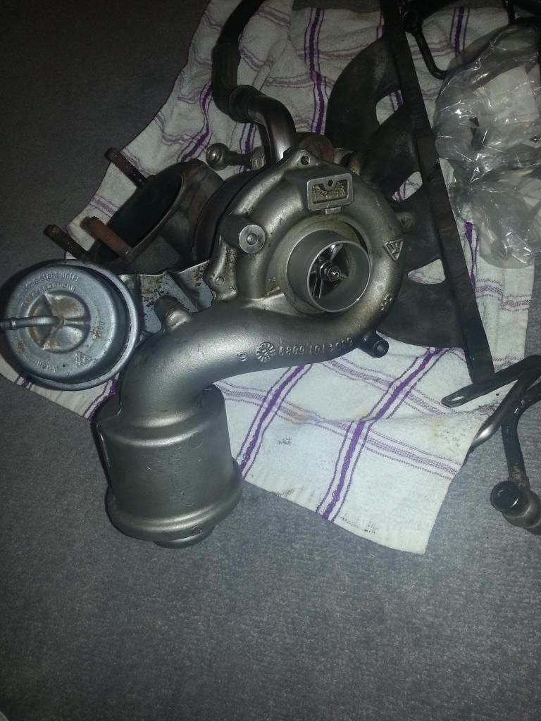

Not from what i can see.. just a k in a triangle.
Heres another pic

Can you post a pic of the exhaust side, where the down pipe bolts on?

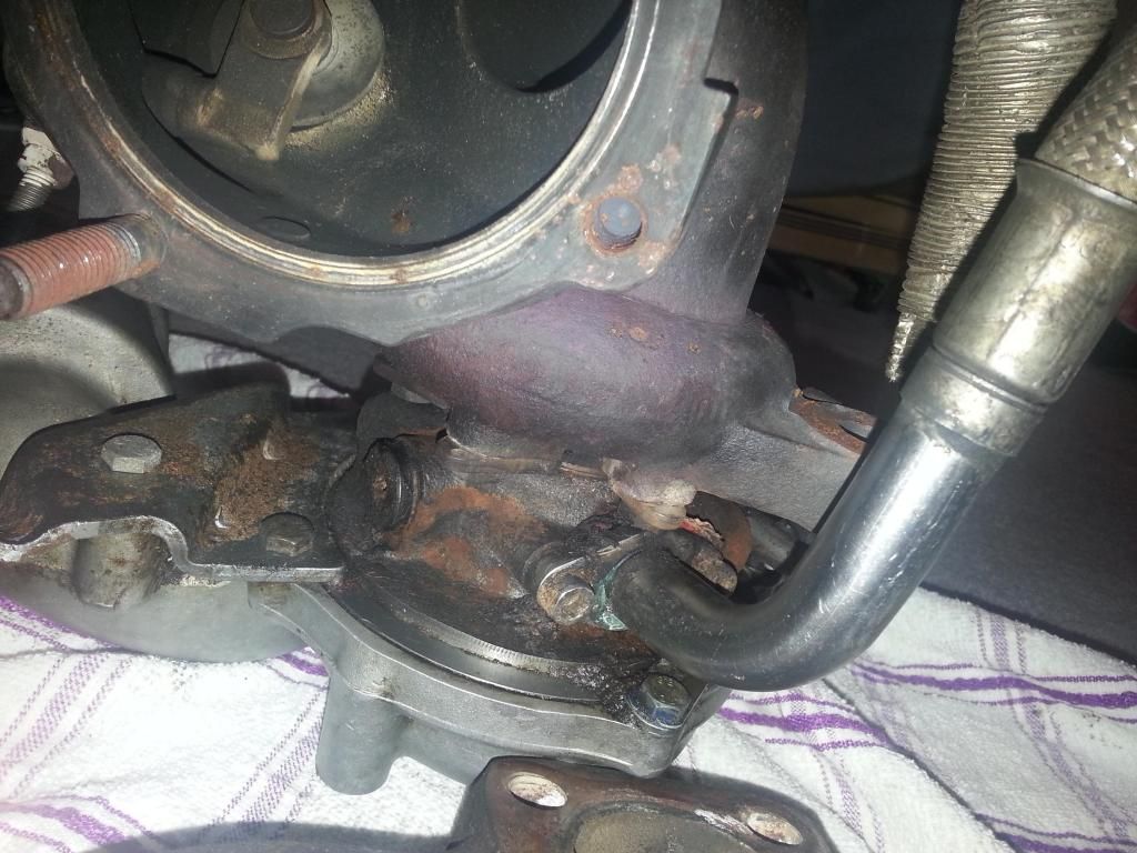

This what u mean?

Up a little! Lol! How much did you pay for this?

I've never seen a 10 bladed compressor wheel in a kkk turbo. The wastegate is a fair bit off center. The compressor housing and actuator look genuine, allthough the casting marks look rough. It's probably a Chinese copy or a k03 that's been repaired with knock off parts. Whatever it is it isn't a genuine k03s.
Aint gna make much power then?
Offline beppe2672
  • Posts: 385
Re: is this a k03s hybrid?
« Reply #18 on: 24 March 2013, 20:09 »
The only way to find out would be to fit it mate! I spent a lot of time looking at Borg Warner turbo bits before building my own hybrid, I've never seen that pattern of compressor wheel.
