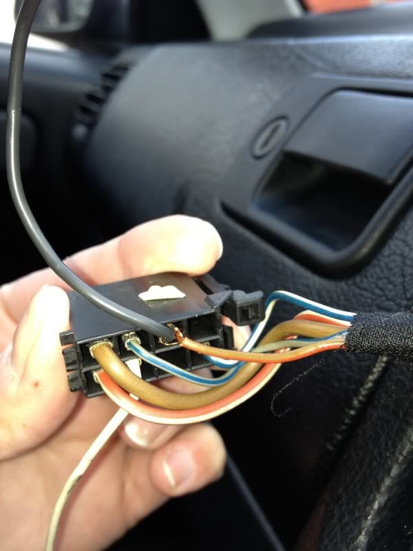

Can anyone advise by looking at the pic below if i have all the plugs in place for correct OBD operation?
what i have tested
Port 4 Earth?yes
Port 7 Live?yes about 9.3 volts
Port 16 Live?yes about 12.5 volts
i can read the ABS controller , but not the engine......
cheers

There's a separate single wire for the obd port to read the engine, its obviously not plugged in
From memory it's a grey wire with a brown male plug on the engine loom side and the same colour wire with a female plug on the car side

i thought it was the brown plug with the grey wire coming out of it next to the grey plug with grey/white wire in the picture? you dont think its that .............

When I did my vr6 swap into the Anni I couldn't get the Engine ECU to talk to the VAG 5052 computer, however, ABS, Airbag scanned fine, I traced it back to that single wire I mentioned not being plugged in, found the wire on the engine loom and car loom side, plugged it in, it worked fine and I was then able to erase the learnt values on my ECU and get the car started
It was a brown plug with a white/grey wire from memory
It does not plug into the fuse box it's one of those single wires that plug into another single wire
I hope this makes sense

I found a brown female plug coming in from the engine bay and it was plugged into a brown male connector which looked like it went back to the brown plug in the pic .

Reading abit more on the net I think my problem is the high voltage across pins 4 &7 . I haven't got a clue on how to establish what maybe causing this.
I had an aftermarket stereo and there was a black cable stuffed in with what I think is the ign live, as in the pic below.
