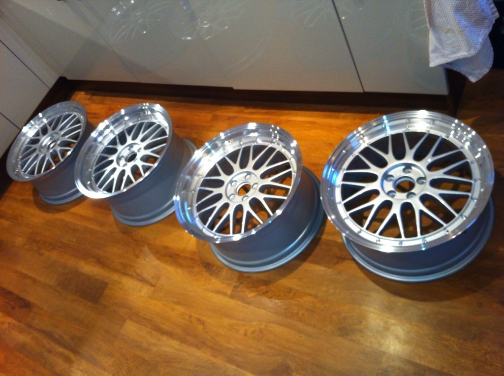

SEALED wheels today!
a freind who is a car "detailer" came round and used SwissVax on them! recons there good for a year or more probably get them re-done before then!
Pics after sealed!
