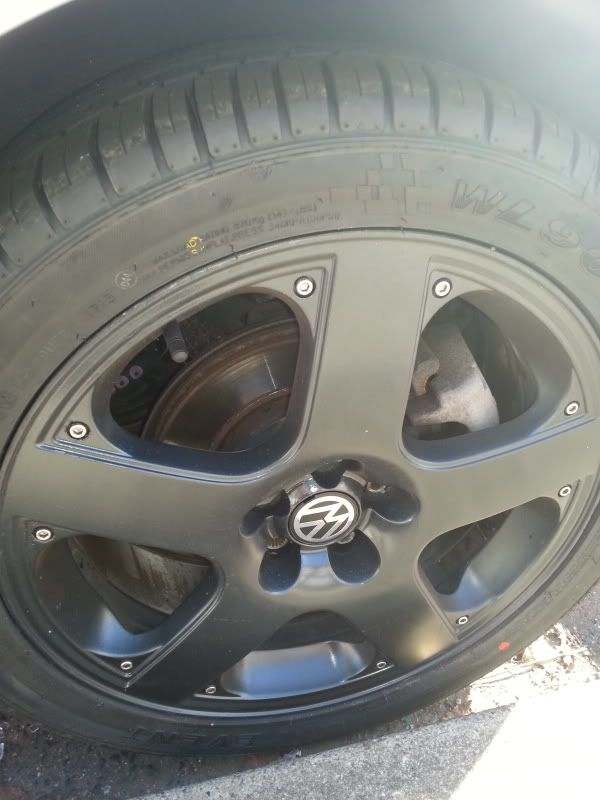

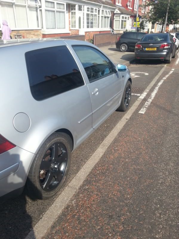

« Reply #50 on: 01 October 2013, 00:36 »

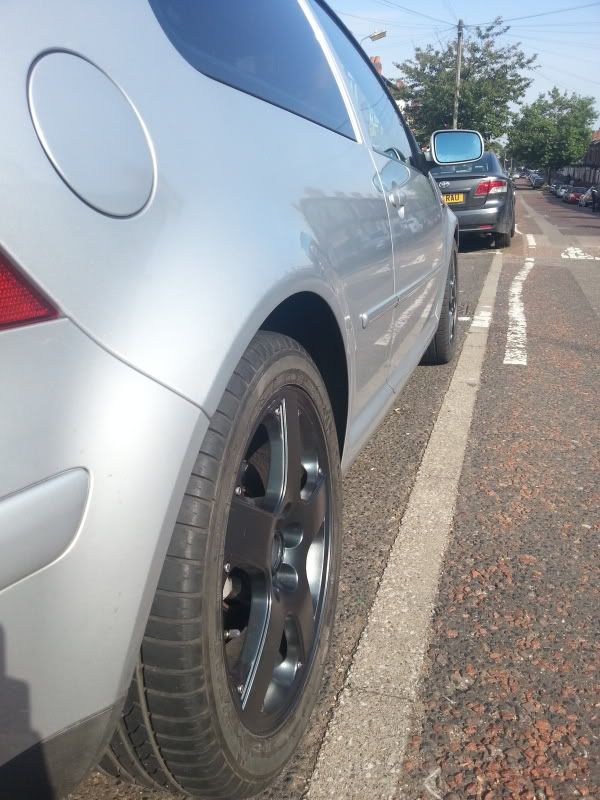

Santa monica alloys are on  :cool:
Very happy with them. Just waiting on the centre caps  :wink:

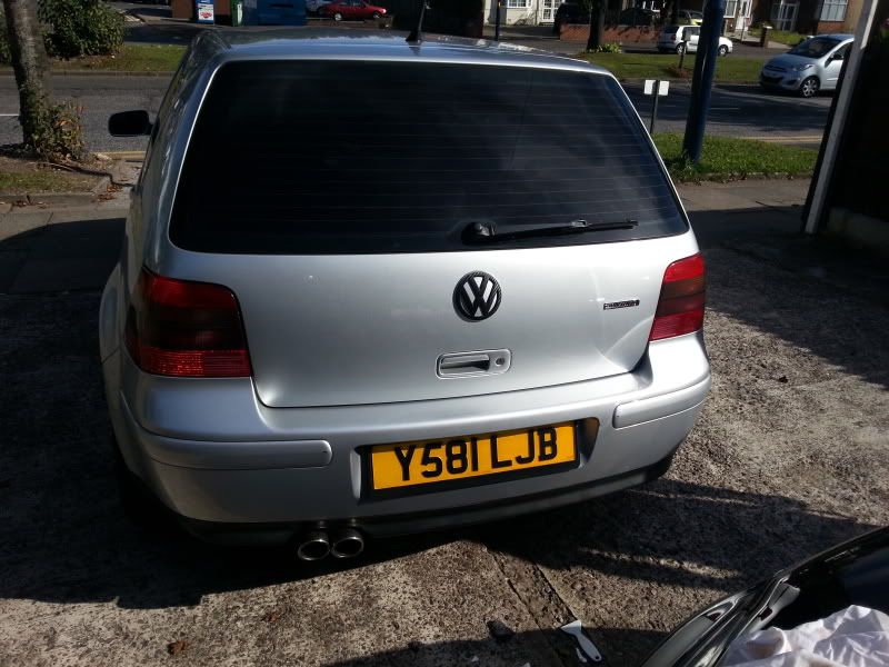

« Reply #51 on: 06 October 2013, 17:17 »

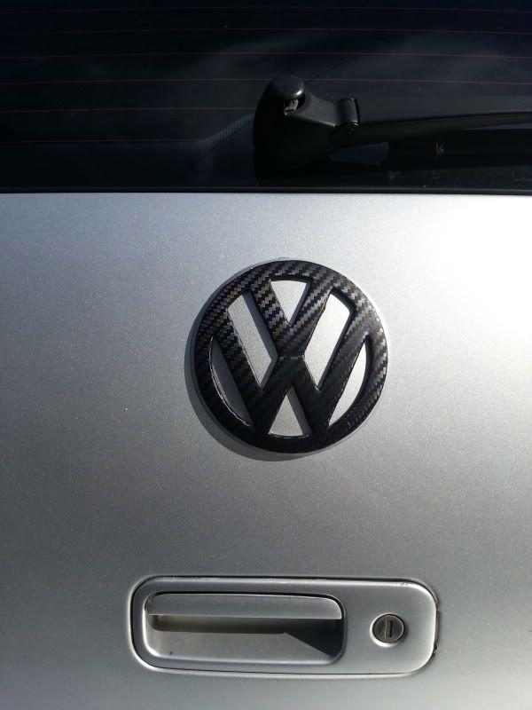

Centre caps on and got on a new carbon wraped rear badge :cool:

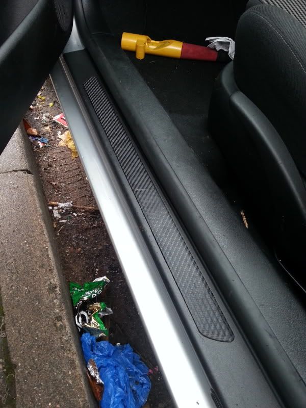

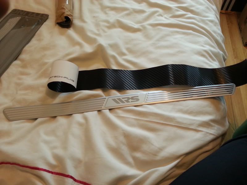

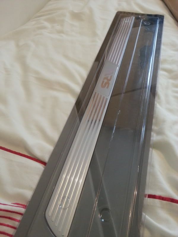

« Reply #52 on: 12 October 2013, 13:58 »

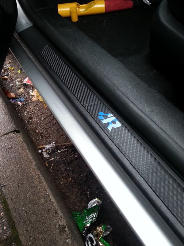

Just made some r line style sills..from £4 crappy ripspeed ones :grin: :cool: cheap diy is the future :whistle:

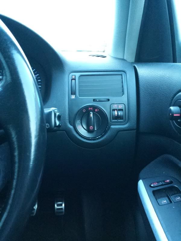

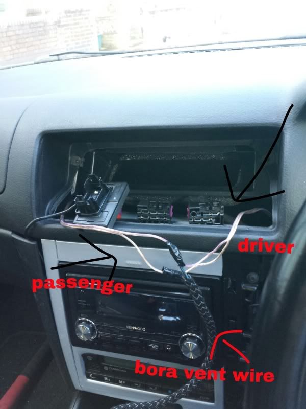

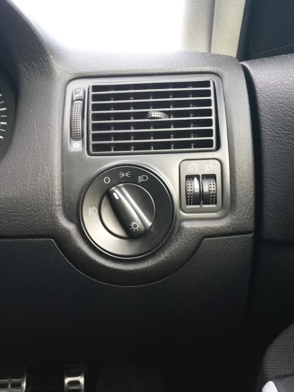

Bora vents in  :cool:
made my own loom out some wire had lying around  :smiley:

Alright bud. How did you go about making the loom?
Just won a set on eBay and didn't get the loom which I thought I did!

Offline navmk4gti
  • Posts: 4,453
Re: navmk4gti - 4motion
« Reply #55 on: 09 November 2013, 19:46 »
i just used some speaker wire i had lying around :wink:
i conected passenger vent to centre vent then bridged wires from there to drivers side too.
This pic might give you an idea..
just get your power from the dimmer switch.brown for earth and blue/grey for illumination  :wink:
Website: https://www.theonestopledshop.com/

« Reply #56 on: 09 November 2013, 19:52 »
I get that bit haha, What connectors do the vents have? Can you take them from the standard ones if they don't come with?

« Reply #57 on: 09 November 2013, 20:17 »
I never used the conectors. Just twisted wires around each other and put insulated tape around them.
You dont HAVE to use connectors just makes it more plug and play if you do :wink:
Do your bora vents have the wires coming out back them to a black plug? This might help if you want to use connectors and make a oem loom..

« Reply #58 on: 09 November 2013, 20:19 »
Your standard vents wont have connectors as they are not illuminated vents.  :wink:

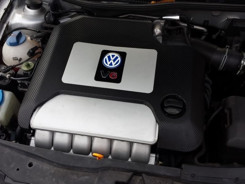

« Reply #59 on: 23 November 2013, 13:48 »

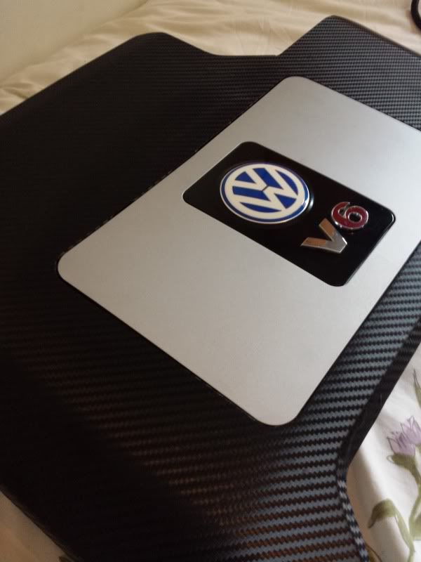

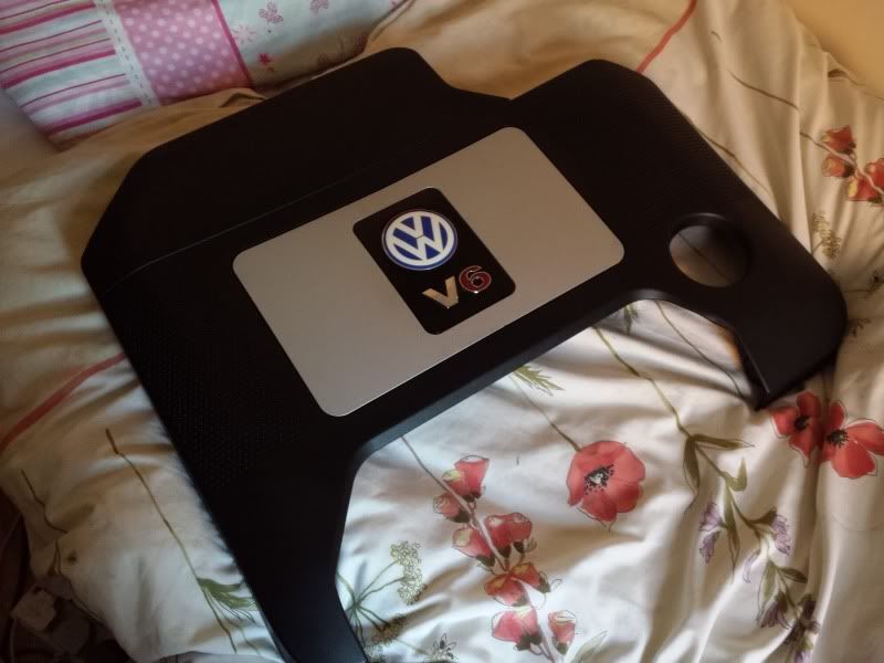

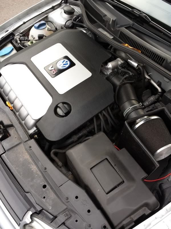

Wraped the engine cover  :cool:
 ]http://i253.photobucket.com/albums/hh60/naveedali1/20131123_125931_zpsc5a0d250.jpg[/IMG]
