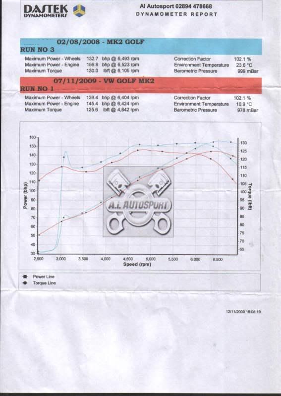

id go by your wheel & torque figures, personally the calculated fly are overly high.
http://i5.photobucket.com/albums/y186/Gambit001/RR_Compare-1.jpg
either that or i have a monster 1.8 16v
The RR plots are difference between KR & Autotech cams, on the same 1.8 bottom end with p&p head
