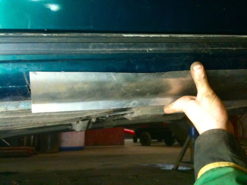

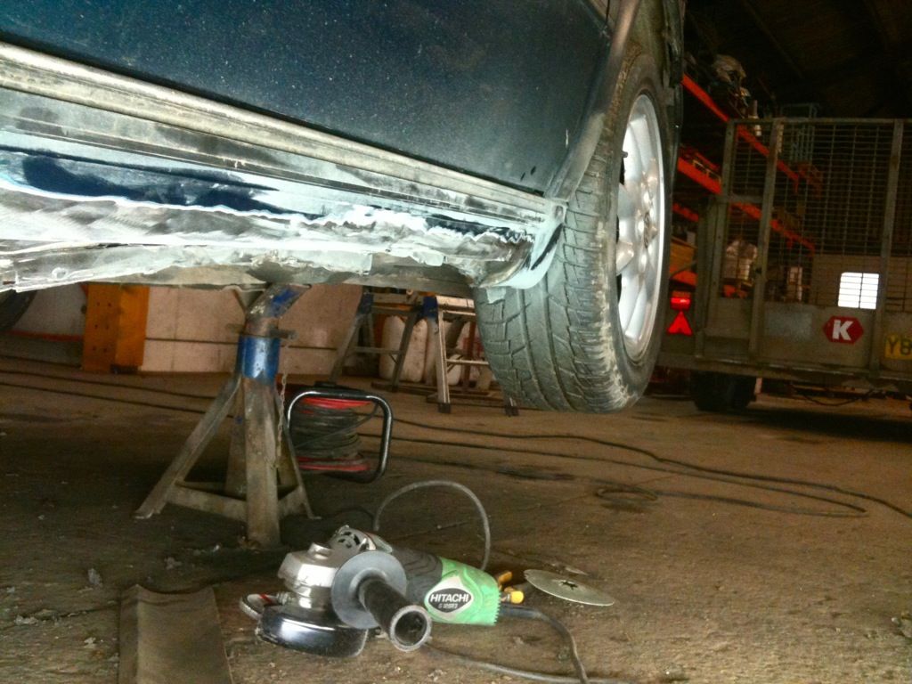

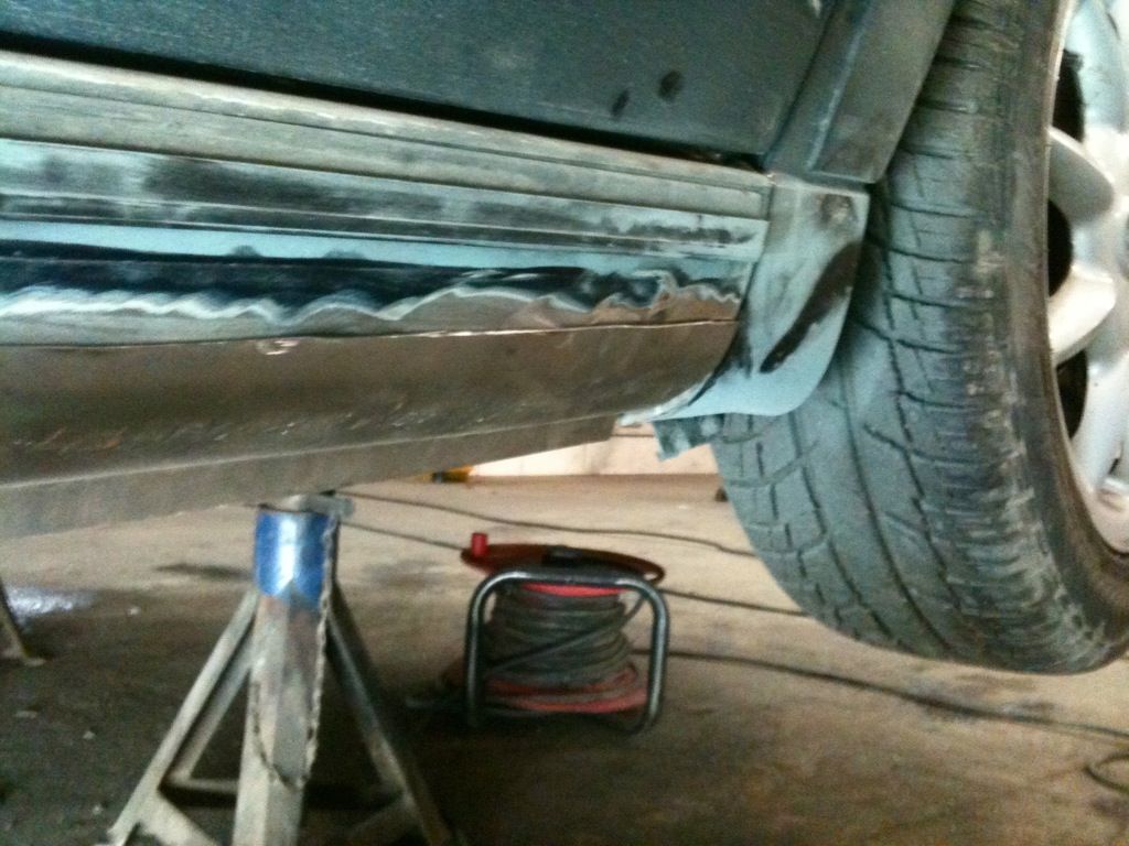

soo finally got round to starting to sort this today, here's some pics..
bent bit of sill cut out
started to cut rust hole out. rust wasn't as bad as i thought, still gotta work out how to do the back part.. the worst bit was that the sill was bent up for 80% of the length of the drivers door
made a new sill from some sheet that i bent and pressed and viced
should go on nicely, just gotta get the underneath bit sorted tomorrow. will put more pics up tomorrow!
