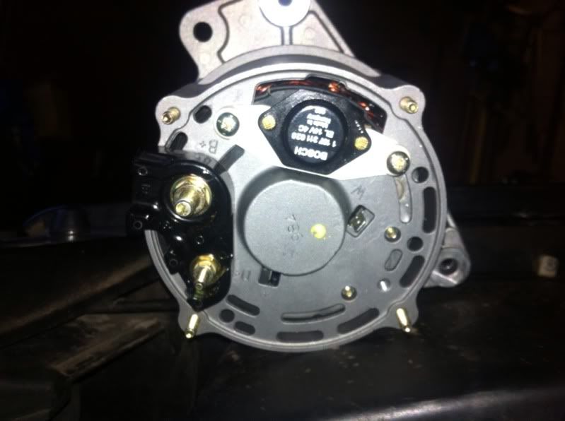

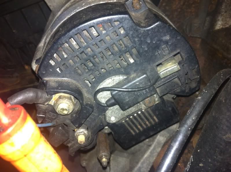

I picked up a new (opened from packaging but never fitted) Bosch alternator from
eBay for a great price, and just had a look at them
side by side.  It looks like a straight swap, other than the black piece in the middle that has a wire that plugs into b+ slot. What is this and is it something isn't required on the new alternator?
New alternator
Current alternator
Thanks in advance
Pedro

it isnt needed. your new alternator will work fine without it.
edit: turns out your black plug is a "Suppression Condenser" on older alternators for radio interference etc
http://www.ehow.com/facts_7822794_condenser-do-alternator.html
Great thanks, I should get it fitted tomorrow fingers crossed
