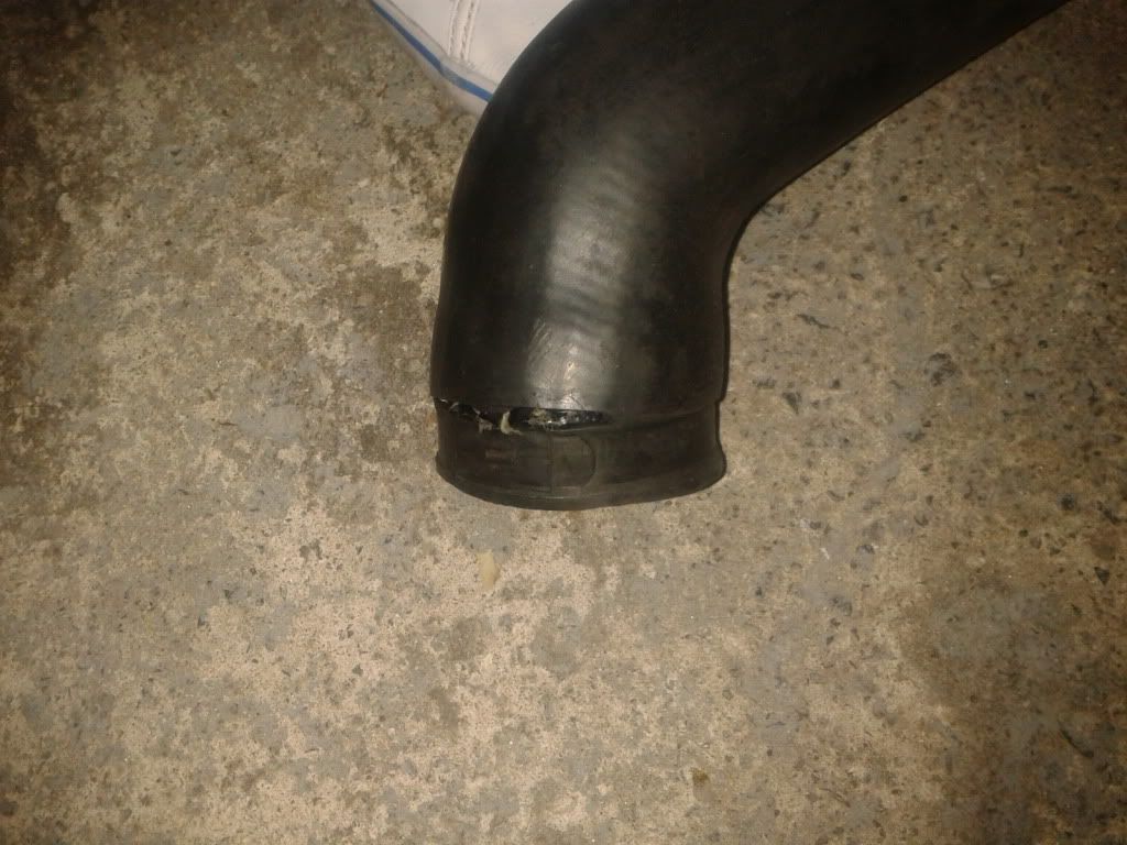

it's not odd that it's reaching 12psi and staying there at all, your system is obviously no longer airtight above 12psi, the hissing you're hearing is the turbo trying to make more boost, and it's all leaking out at a steady rate from somewhere! it's pretty logical that a leak would give you stable, but reduced boost.

Mine leaked... which is why I had it welded over

Split pipe from charge pipe to pancake pipe lol nice big one too  :grin:

Mines just started doing this! But I'm at 15 psi but I've got a hissing and a weird chattering, fluttering sound. How did you find your boost leak mate? With a pressure tester or something?
