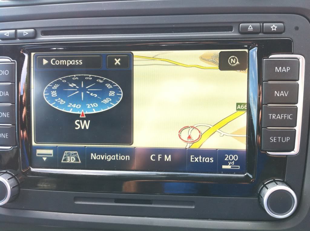

« Reply #85 on: 20 August 2012, 23:27 »
Right i've just downloaded them and copied them from the SD card on to the RNS and they work bud, mind i had to zoom out as we've only one anywhere near us  :grin: You can add a few actually so i'd suggest copying that file on Sd card and adding it to the RNS.
