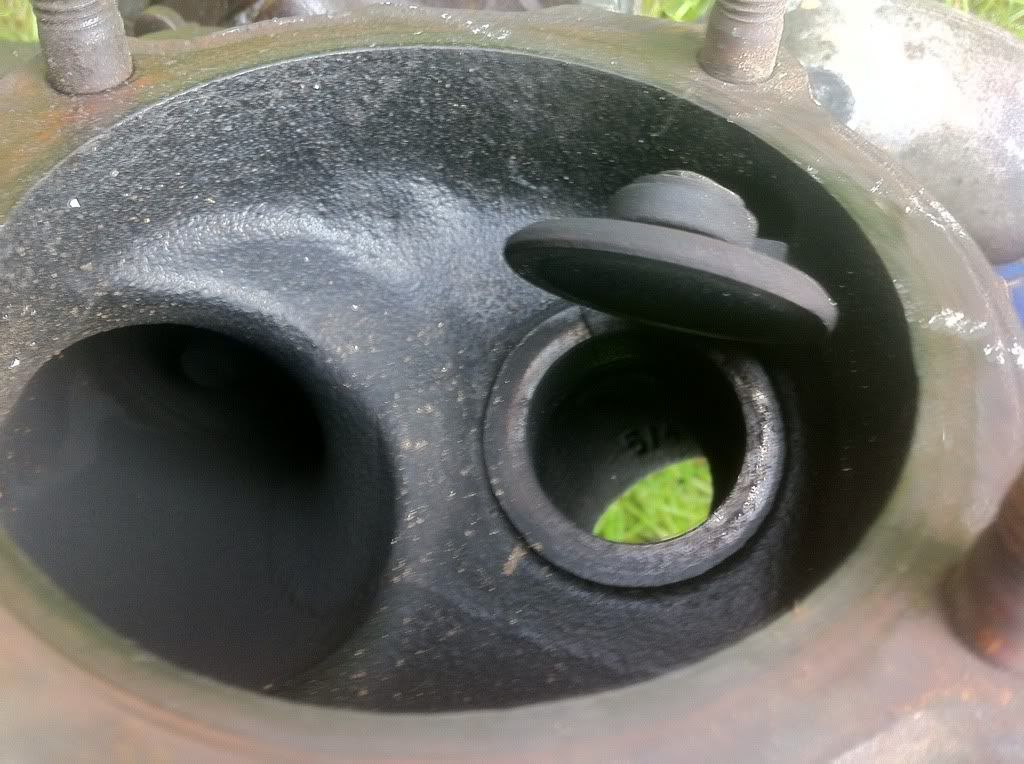

250bhp from a ko3S requires a huge spike, around 25psi at 3500rpm, from the back of this it makes monster torque, almost 300lbft, and as power is a product of torque and RPM, the horse power is made very low down, peaking at 250bhp around 4500rpm. What you end up with is a car that's very fast, but not actually that amazing to drive. Something that's a little more reigned in to around 22psi won't have that spike, and it won't generate nearly so much heat and will be able to pull on hard right to 7000rpm.
This was the inside of my ko3S after 3 years abuse:

you didn't keep the housing then mate  :grin:
Offline Prawny
  • Posts: 456
  • R-tech power!!!
Re: How much will a AGU take?
« Reply #33 on: 17 August 2012, 15:53 »
No, I stuck it on a golf and sold it  :evil:
my hybrid is a ko4 hybrid anyway :) ko4 housing with billet comp wheel and RS6 turbine on a relentless mani. obviously with a R-tech map!

Then of course there is the reliability factor....Mine got pushed pretty damn hard from day 1 when it was mapped back in January 2010 (i think) when the k03s first went on and made 225bhp and 225lbft with few mods.  When I took it off my 248bhp engine/map, there were cracks in the collector housing and a small crack in the wastegate housing...but you have to ask yourself.....what k03s turbos dont have small cracks in them?  Ive yet to see a one which isnt cracked tbh.  Not one bit of smoke or dodgy rattles at all from mine and minimal shaft play....of what is perfectly normal for a wet float bearing turbo.
Heres the crack in question:
One of those that when its warmed up, will be sealed.
