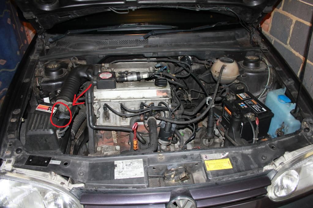

Quote from: Screech16v on 08 July 2012, 20:44
Unplug your MAF and then drive it see ifs its any better.
Is it the bit in red I need to unplug?
Looking for a cheap set of 17's
stu 88
Here all the time
Posts: 270
Re: Need Some Help Getting My 8v Gti Running Right In West Sussex
Reply #14 on:
09 July 2012, 10:37 »
As above! is that the bit I need to unplug? dont want to unplug it if its not the right one!!
mrsaunders
Posts: 575
Reply #15 on:
09 July 2012, 11:20 »
Yeah thats it
stu 88
Here all the time
Posts: 270
Reply #16 on:
09 July 2012, 17:07 »
Unpluged it and it made it worse!! it kept stalling at idle
