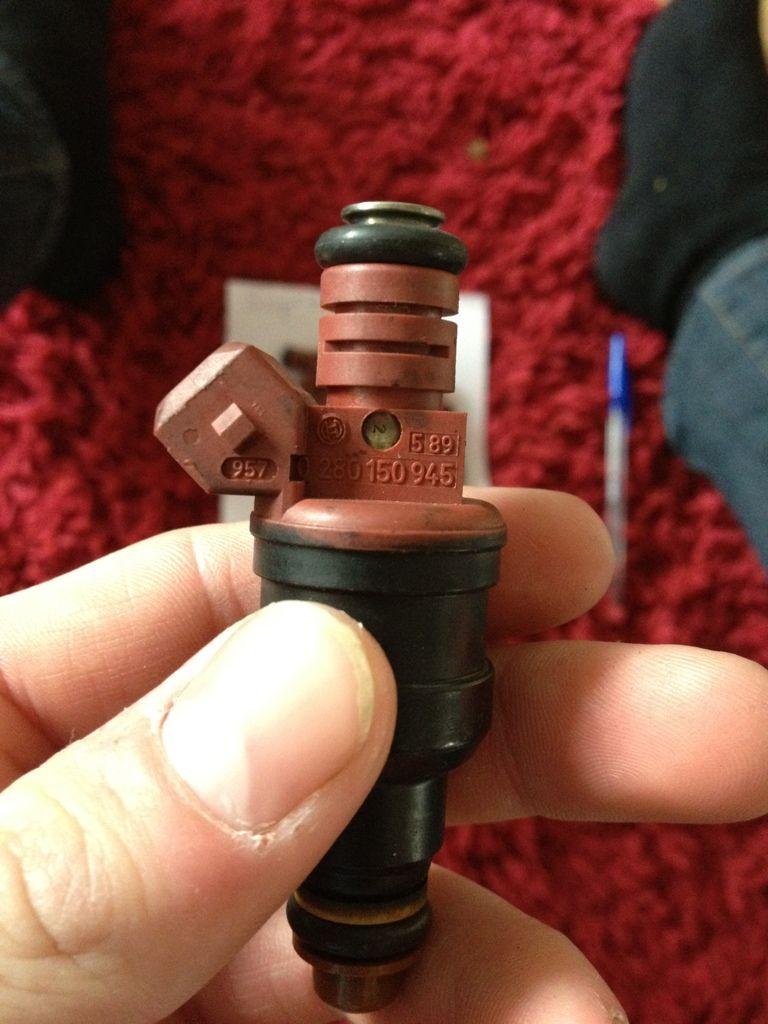

yours AGU?
then saab reds will work!
get a badger 5 tip aswell  :cool:

The injectors for your AGU are EV6 type fitament which are low impedance (1.2 Ohm) versus the TT/S3 injectors which are EV12 type and high impedance (12 Ohm)
In short I'd look else where for injectors, Calibra yellow's come to mind  :smiley:

Right ok so s3 don't fit ?
Do you know off hand a list of injectors I could go for ? Looking for 440cc most probably but want to keep cost fairly low :-) .. In regards to the maf can I use an s3 one ?

Yep use s3 MAF :afro:
Look above two injectors already suggested  :wink:

thnk you can also use vxr ones too  :undecided:

So what cc are vxr injectors ?
And what cc are the above injectors ?

vxr are 480cc
toby whar are the reds??!!!
Sorry not very clued up :-/
380? Or 440? I can't remember but there Saab reds!!
