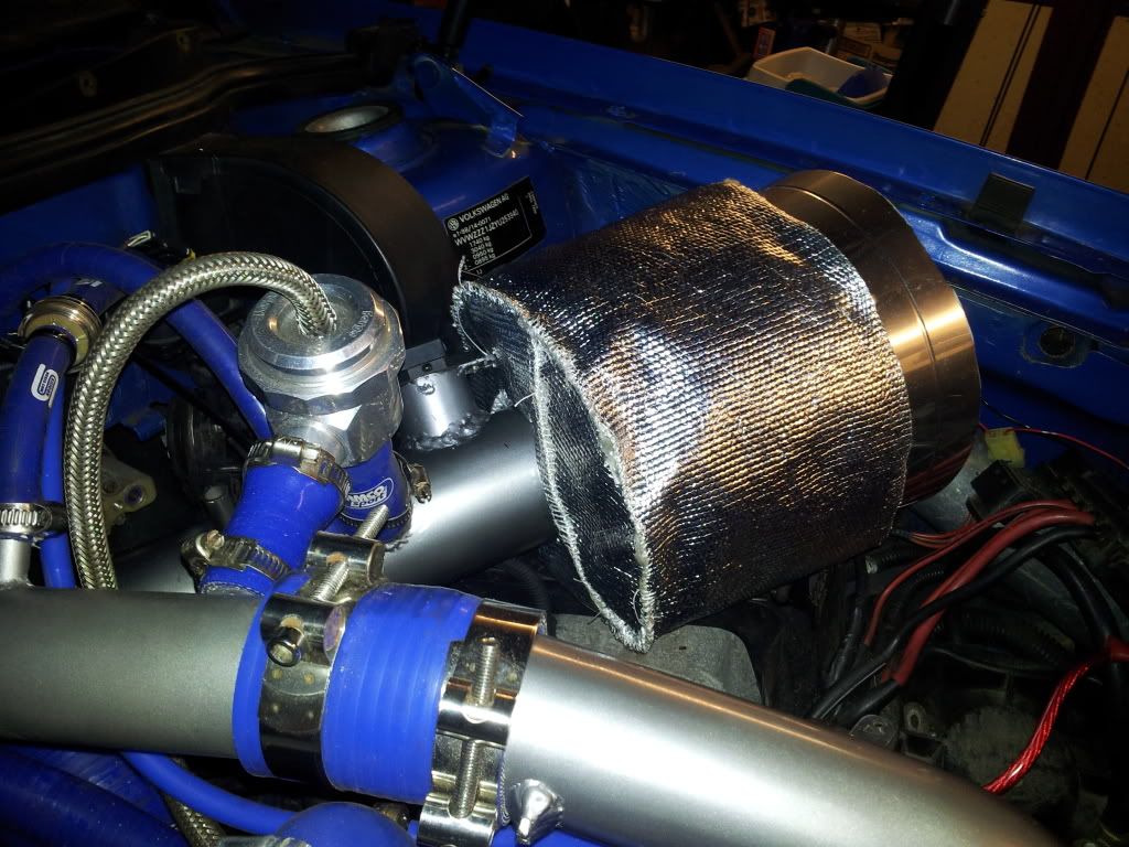

I had the cone filter by the bumper but got scared of it sucking up water so moved it to behind the battery. I made a heat shield out of a champange bucket, insulation and some heat reflective material. Then used the old pipe to make a cold air feed from the bumper.
Dont have to worry about water now, will get a good cold air feed and the shield cost me about £15 to make.  :smiley:

nice effort mate, I like that  :cool:

10 out 10 mate loveing that!
