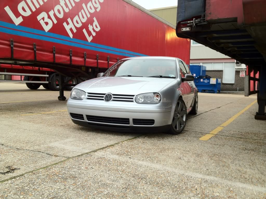

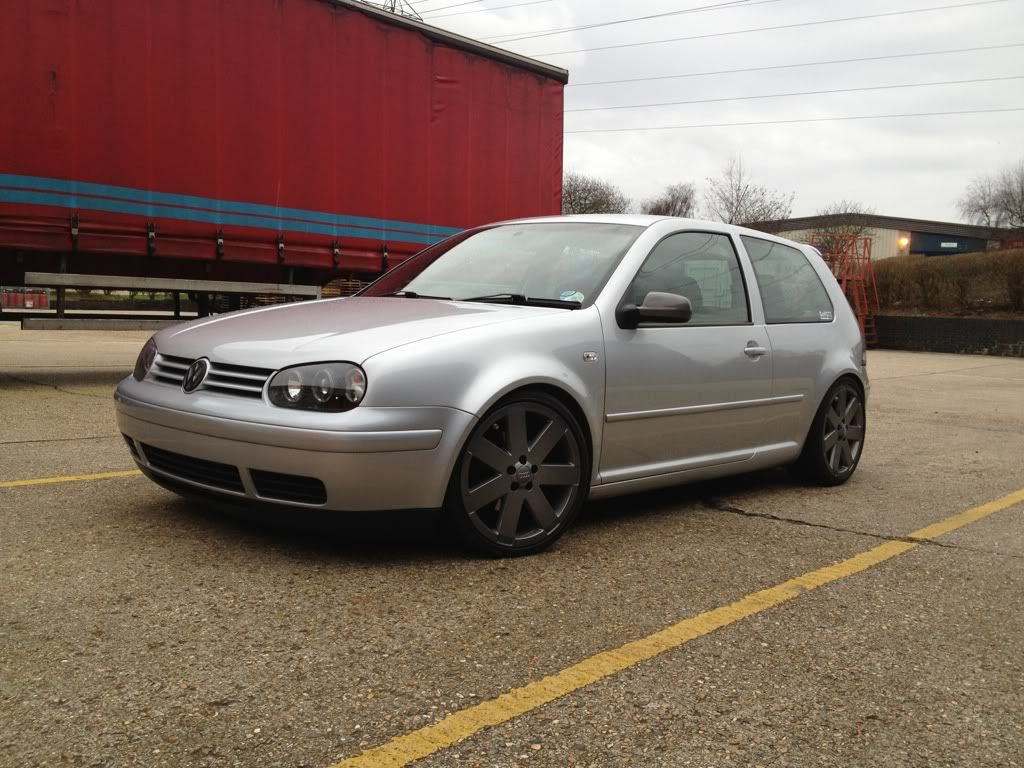

Haha Im gunna have to instal an alarm on it "wazzer alert, wazzer alert" its not mint but im happy with it i gave up trying to follow the line on it and the paints slightly darker than the car
If you want one done mate il happily do it for ya the way i done this one was easy !

Paints come out pretty good for a rattle can job !

Pat yourself on the back kind sir! :cool: :cool:

good job mate! :smiley:

 :evil: it looks soooo bright now were ive had the green bumper on lol :laugh:

Looks spot on  :cool: Good job with the rattle cans :afro:

Small things are easy to spray the bumper was slightly harder lol

you sprayed a whole bumper with rattle cans? blimey thats a good job. you must of polished the sh!t out of it to get that orange peel out!

Na mate you cant polish orange peel out if its in the paint on metalic i done 3/4 coats sanded with 800 to flat it out 2 uberlight coats then laquer then compound then polish
You can see the orange peel slightly but not in natural light only when your upclose with a torch. I saw a 10 plate beamer with more peel in it than my bumper which made me laugh
