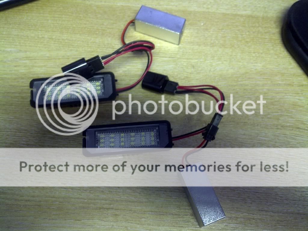

They been in since mid August.Error free.There is what they call a canbus which is a resistor module that stops any errors and comes with the lights.You just place it into bumper before putting led light in.

The CanBus is the electrical system that is in the Golf, and many other cars nowadays.  It allows the car to communicate with the electronic devices in the car.  The resistor box you have makes the LED lights CanBus compatible by tricking the car into thinking the LED lights have the correct resistance... as LED bulbs use much less power / current than regular bulbs.

Just been delivered to work   :smug:

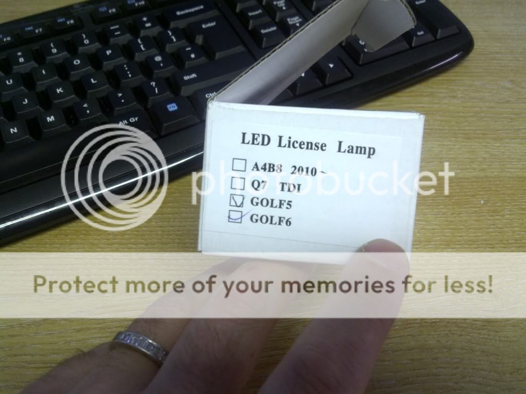

What does the box they came in look like?

Hang on a minute and I'll get a picture of the box just for you....... sorry I didn't get a picture of the postman though?  :smiley:
