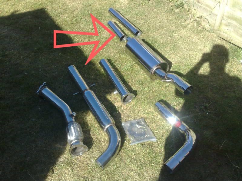

« Reply #17 on: 17 December 2011, 13:21 »
You have two 90 degree bends in your exhaust already..
Elaboration;
See pic below, fit exhaust as usual from front backwards, when you get to backbox, you will notice this finishes under car and doesn't poke out, you have choice of two tailpipes (long and short / hatchback and estate) which bolt to end of the backbox, which stick out the back.
So you have to either, get someone to put a 90 degree bend into one of your original options, or buy a bend, cut a flange off one of them, and weld together.
I have put an arrow pointing out the bits you need to pay attention too for your viewing pleasure.
