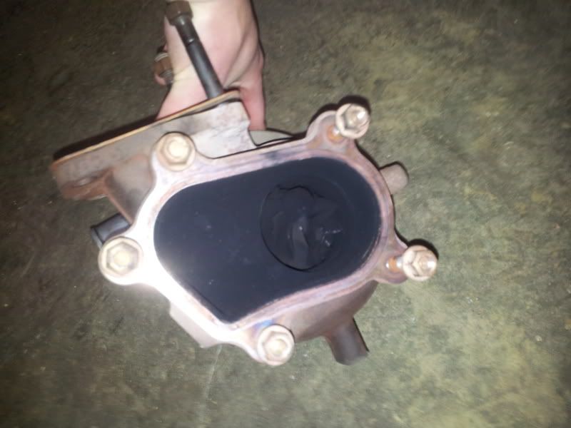

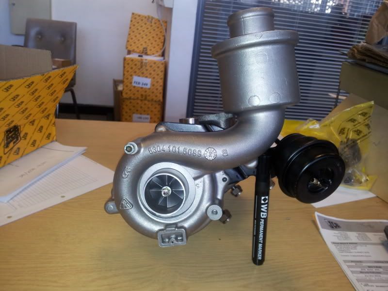

What lovely weather weve had here in Norfolk the past week, Dare I say summer has officialy started!? :lipsrsealed:
Well...... A few of the lads at work knew ive been desperately waiting for some bits to arrive and today I was working out in the yard when a courier pulls up, Thought ahh brilliant hopefully its for me carried on working knowing that one of the office lot would sign for it bla bla bla. Anyway 10/15mins pass and I get called in for a Brew and was announced that a parcel had indeed arrived for me. Brilliant I thought, quickly finished off what I was doing then headed in.

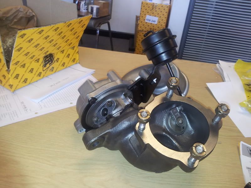

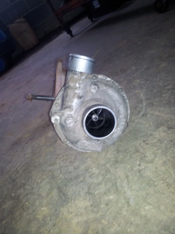

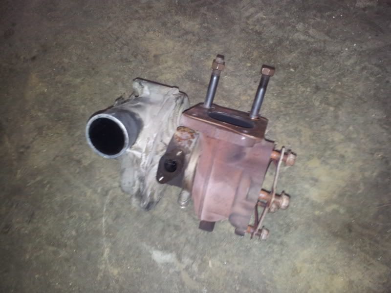

Sat down and there was the legit parcel all addressed to me bla bla bla, Started carefully opening it up and sieving through all the polystryine and card.... Well F#CK me, My heart sunk as my blood level rose  :angry:
Infront of me was this...
Well  :shocked:  :angry: I didnt know what to do the f#cking thing almost got launched accross the workshop, Not only had I recieved a different turbo, its an absolutely knackered:cry: though great Ive been scammed big time.
then a few of the lads came in and started winding me up that I had been mugged off which really wasnt helping seeing I was getting closer to exploding  :grin: then they all burst out laughing and handed me another parcel  :rolleyes:
ripped the new one apart and inside this beautiful looking GEM greeted me  :smug:
Got well and truely stitched up  :grin: :grin:
Should of known something was up at the beggining seeing as everyone I work with are top notch wind up merchants :grin:
What they'd done is gone through the engine warranty box and found a turbo has a snapped turbine under a year old :shocked: and parcelled it up for me  :sick:
The new blower Is a brand New Genuine OEM K* series with all gaskets and fitting  :cool: :smug:
Sorry for the life story  :grin:
thanks for reading will be updating again very soon  :cool:

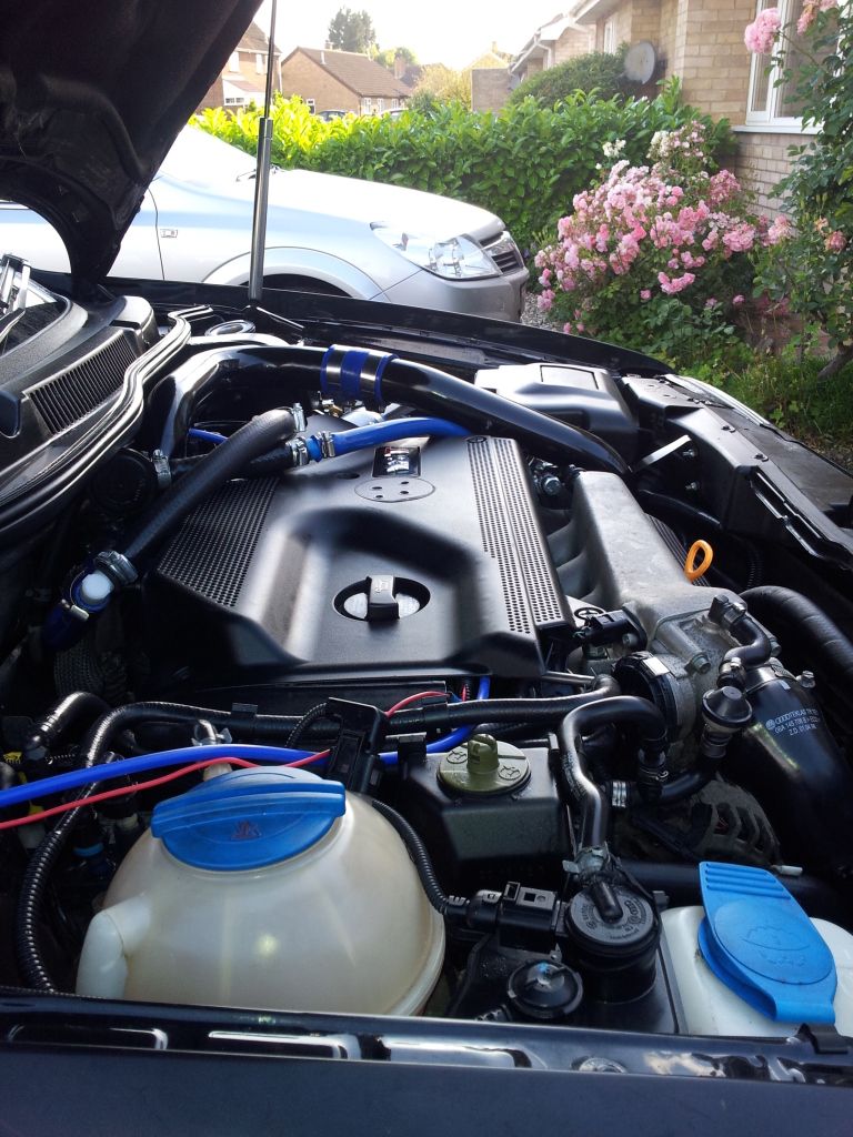

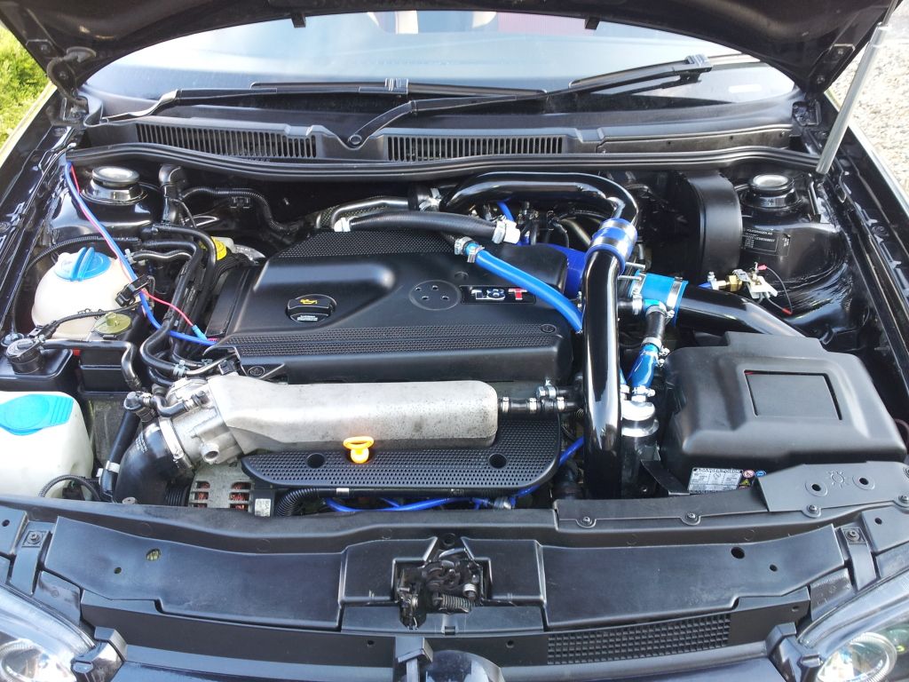

Following on from a few updates ago I fitted my catch can :cool:
Could I please have some clarrification as to whether ive installed right!?
*T'd off the rocker cover, one going going back down to the oilfilter housing area other going to one side of the catch can.
*Blanked off two nipples on the underside of the inlet manifold.
*Blanked off one side of the y piece that goes onto the side of the inlet manifold, think it has something to do with the brake bolster.
*other side of the catch can to the oil puck on tip !?!?
out with the old
Look at the sludge that gets recirculated back into the intake  :shocked:

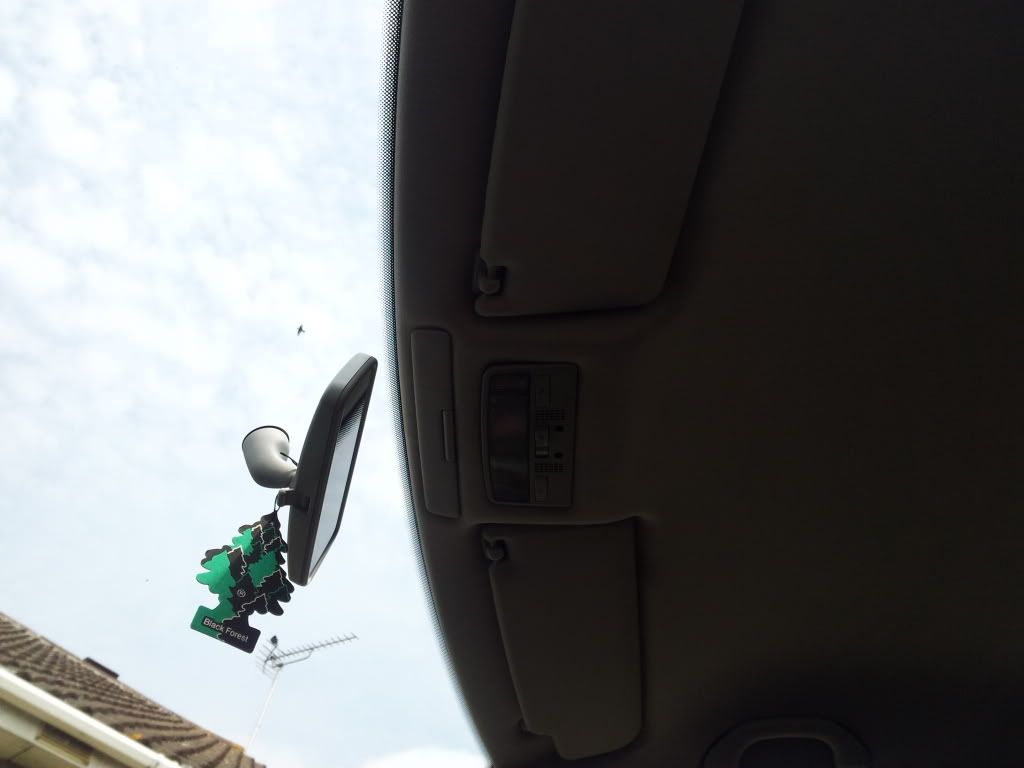

I also managed to break my drivers side bora vent  :sad:, Basically the slates have got a tiny plastic pin on each end which is attached to a lobe which inturn follows the control of opening/closing mechanism... yep I maganged to break alot of them off which just used to annoy me so I purchased another one
some other bits I have been hoarding
Yep you probably guessed right, genuine brushed ali

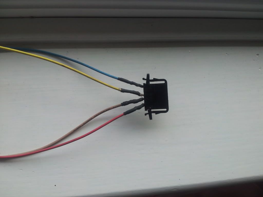

Also managed to sort out the wiring for the w8 light so its a simple plug and play  :cool:
I thought Id try and be a bit original here and im quite pleased with the outcome, normally im not a big fan of the stuff but I think this is a nice subtle finish  :cool:

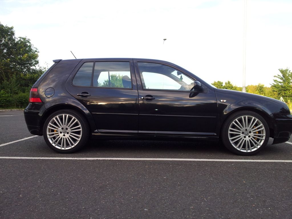

Front before
Front after
Rear before
Rear after
Desperately after a 25th anni splitter then I can officialy say I love my front end haha

Went and picked up 50 liters of 99.95% virgin grade methanol at 80pence a litre. Ive been advised to do 50/50 water meth so that little lot should last me a while  :smiley:
Now for the install  :wink:.
First thing I did was drilled the tank so I could fit the inline filter and main feed from the tank. Might of got a bit carried away with the 'dab of silicone around the edge just to eliminate any pottential leaks in the future'  :grin:
Front end dismantling to mount injector
After speaking to a few people who have already installed W.M.I I found the best place to mount the injector was after the intercooler allowing maximum time for the water meth to cool down the charged air.
after marking the spot and making sure the injector would be hidden and free from obstruction I drilled, tapped & sealed it in  :smiley:
different angle
Next was too route the feed line from the injector to pump.
VW kindly thought whilst desigining the golf about the possibility of enthusiasts installing W.M.I kits and such things and created an extra 'alley' for the line to clip into  :drool:
Bit more routing
For optimum access I decided to mount the manual boost solenoid here for ease of changing the boost the W.M.I kicks in at 7psi
I Figured Id like the pump hidden out the way, whilst having the tank at an easy filling place so decided to mount things like this!
(parcel shelf removed for purpose of picture)
Now for a little review. Well.... For the money it has cost (Sub £300) this has been the most beneficial/noticeable mod I have done and bearing in mind you get optimum results with a map (WHICH I HAVENT DONE) this really has been my favourite noticeable mod. Installing was a piece of cake, It litterialy consists of earthing the pump & solenoid, Live battery + to the pump, 12v ignition feed to the pump, vacumm feed to the solenoid and away you go! I dont have vag com so couldnt tell you of any actuall intake temperatures, how ever after a hard run (and I mean hard  :tongue:) the intake plenum is ice cold to touch (quite litteraly). Having the hot fmic pipe so close to the manifold it is quite amazing the temperature difference between when the charged air comes out of the turbo to the charged air that enters the inlet plenum :cool:. As far as useage im doing about 2 tanks to a full tank of fuel which I dont think is too bad!
ALL IN ALL I WOULD HIGHLY RECOMEND GETTING ONE :cool:

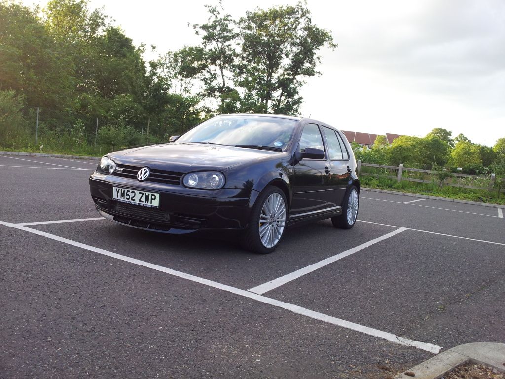

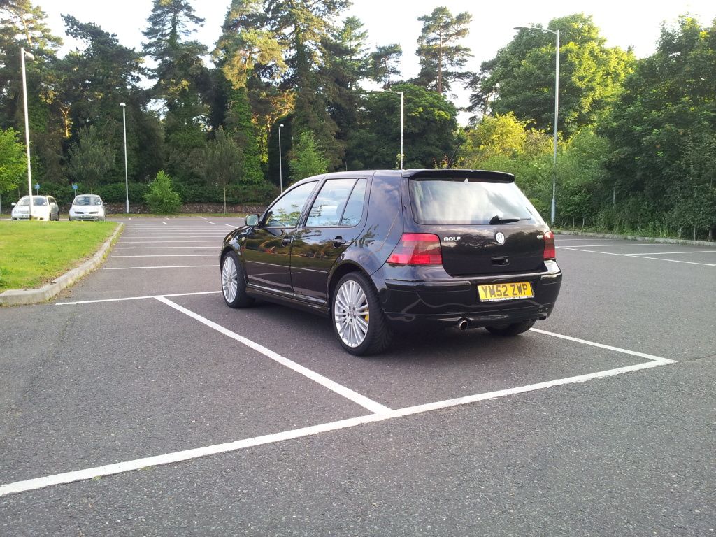

Following on from last time My rear anni valance turned up  :cool:
so got that fitted straight away
I also got myself booked in at R-Tech yesterday for a Stage 2 Custom remap  :laugh:
This has been well over due but I cant believe now after knowing how much difference its made why I put it off for so long. It took me the best part of 3.5 hours to get there but boy was it worth the drive, especially on the way home  :shocked: :cool:. As soon as I got there the guys got stuck in checking everything was all good and safe explaining what was going to happen :smiley:.
In the first 30-45mins session on the dyno the guys maxxed the set up out at 199bhp  :huh: with a missfire. (Toby your guess what right  :grin:) How ever after they had a quick look around they soon noticed that I had made a school boy mistake by not tightening something on the intake manifold allowing a boost leak. Within the next 1.30 mins they switched the engine off and started indoing the safety straps to get the car off the dyno. With the new live software they have everything can be done twice as fast so to say I was itching for a drive was an understatement.
Even though it was way above my head they took the time to explain they had [b]*[/b]maxxed my set up out  :cry: showing me all the figures, duty cycles etc etc. I then went on a test drive  :laugh: and wow.... I told my friends I was getting a new car to throw them of the scent but this is just as good as. it really is completly different to before. you only have to feather the throttle to cruise and then if you push a bit more it absolutely transforms the car into something else  :grin: The power is soo smooth yet agressive its hard to explain. Overall I am soo happy with what the guys at R-tech have done, cannot recommend them enough  :cool: if your reading this guys, I will be seeing you very shortly with what you recomended  :evil:.
Now the bit youve all been waiting for. Cullygti you were on the money.
They maxxed out my set up with 1.75" intercooler pipework being restrictive :cry:. They said theres easily another 10-15bhp to be had with the 2.5" pipework along with + lbft. They couldnt physically get the K03s to flow any more through the 1.75" pipework as heat soak was becoming a major issue even with the meth injection and F.M.I.C. I also had a leaking exhaust triangle turbo gasket which you could hear which of course was loosing a bit of power along with a blocked/rusty toyosport air filter  :sad:. Either way Im extremely happy with the power they made considering the above and will be getting all the above sorted asap for another trip up there to get some better results along with launch control being added and left foot brake and boost  :laugh:.
The most important bit  :cool: 231bhp & 258ftlb holding a solid 20spi boost  :laugh:

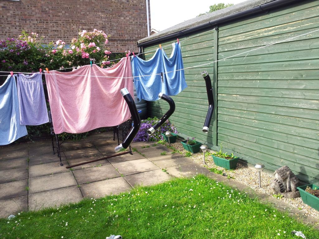

So then…. At the beginning of the week this parcel turned up

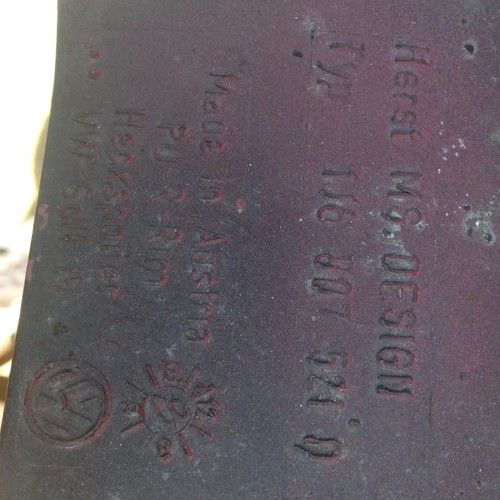

Going by the results I got last time with a rattle can I wasn’t fazed to crack on with these.
So I went and done some shopping and came home with this little lot :nerd:
Checked the forecast before starting and cracked on with the tasks ahead.
The spray booth :grin:, Bare ABS plastic
Several coats of primer :smiley:
Primer wet flated using 1000grit  :smiley:
First coat of LC9Z-Black magic  :smiley:
LC9Z- Black magic Wet flated using 1000grit  :smiley:
Top Clear coat  :cool:
Again Im really pleased with the finish considering its from a rattle, Maybe paintings my hidden talent!?

Ever since fitting the Anni rear valance My exhaust has been rubbing slightly on it hence the exhaust heat rap up the top, so this time I wasn’t going to take any more risks with melting things so It was up to the work shop to do some fine adjustments.
UP she goes  :laugh:

So then people, I need some input Obviously it still needs lowering and stance but what else do you think should be done?
What are peoples thoughts on the wheels? Change completely or painting!?
 was possibly thinking refurbing them in a gun metal grey, but im staring at a blank page with not much imagination
talk to me…. !?

So i got my thinking cap on and came up with an idea :smug:.
Operation stealth :cool:
From this  :sick:
To this  :cool:

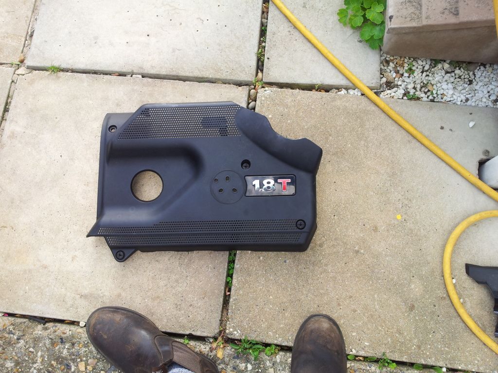

I had to cut the engine cover slightly for it to fit
Hard pipes drying
Also got round to fitting my Anni skirts  :laugh: Have totally fallen in love with my car again :cool:

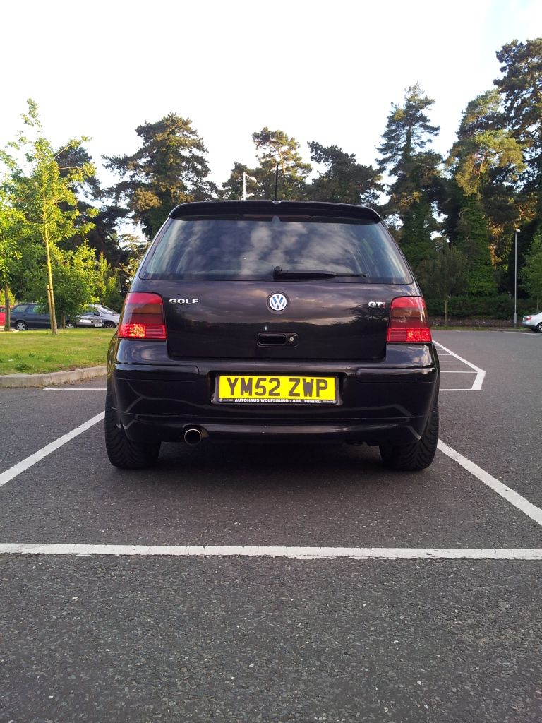

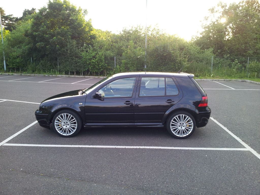

This is going to be some propper picture whoring so appologies in advance.
The weekly detail  :cool: So much easier now the hose pipe ban has been lifted  :shocked: :laugh:
Reflection b!tch :nerd:
Thanks for reading, any advise crisitism more than welcome
