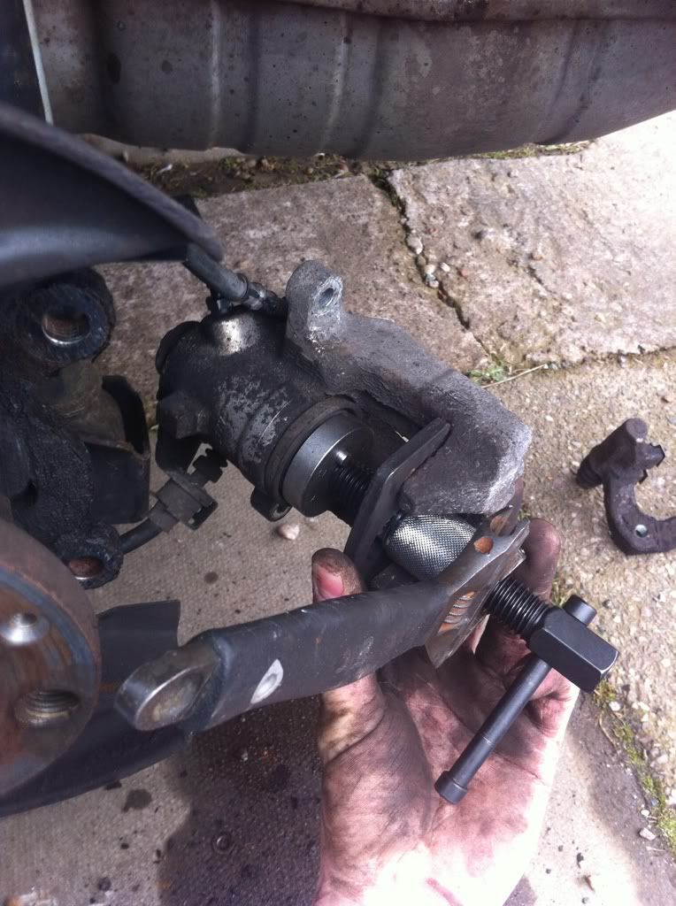

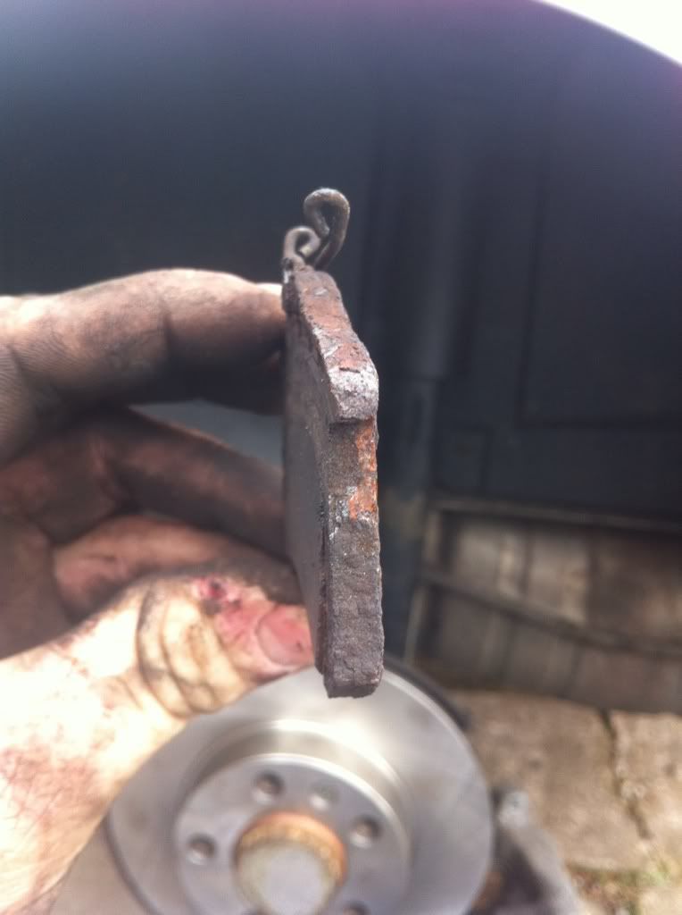

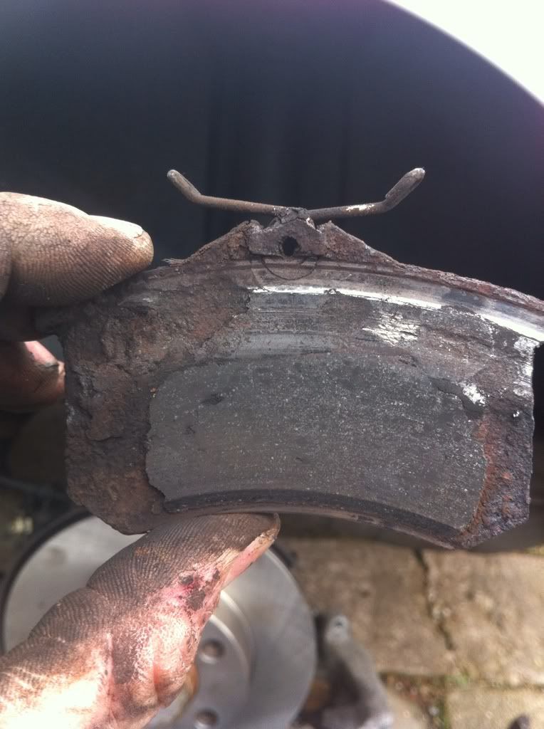

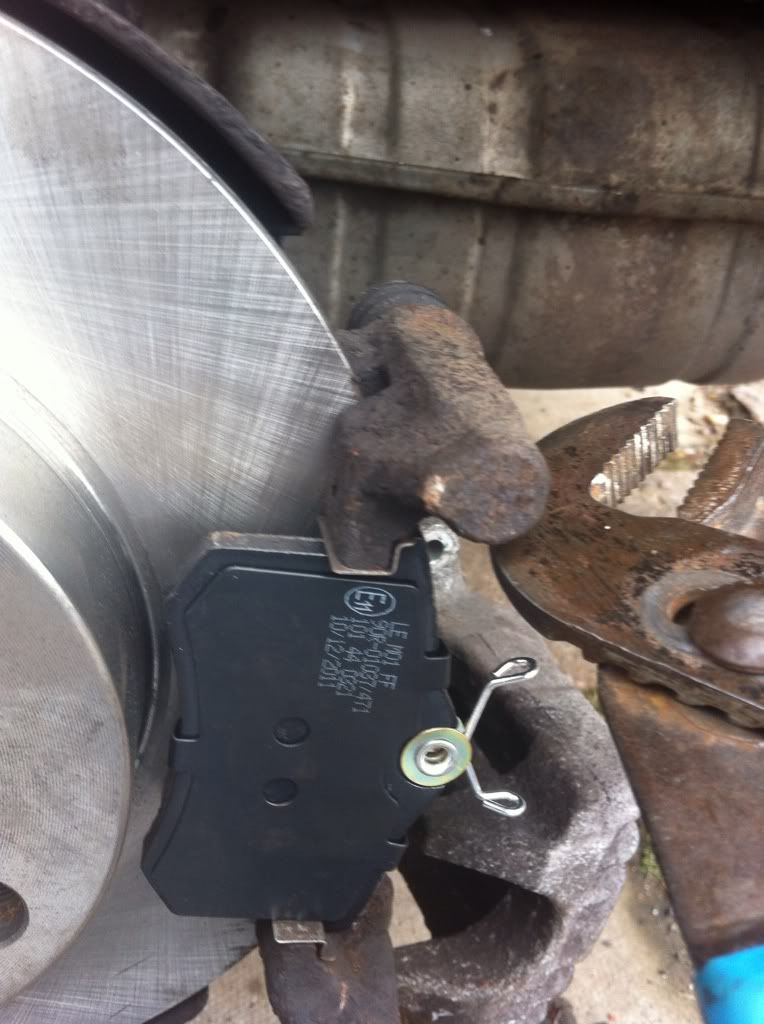

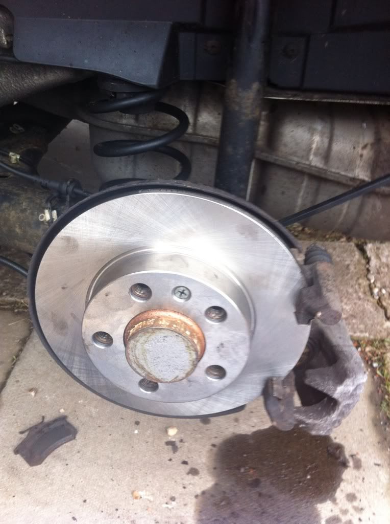

and then had the loveley task of doing the rear brake discs and pads!!
look at the state of these!!!

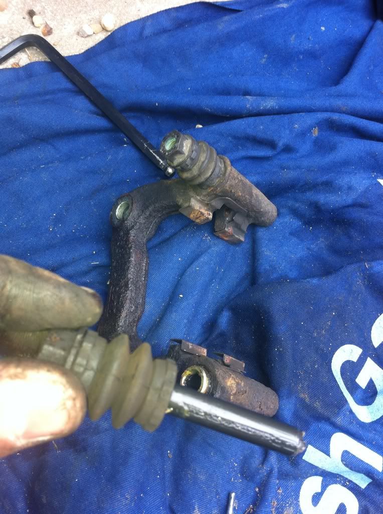

much needed by the looks!! so removed the lot callipersd and carriers re greased the carriers as they were seized!!
and there looks much better haha well better than rich tea biscuit discs and shot pads!!
windback tool a must!!  :grin: even if a bit pricey at £30.00  :sick:
replace all with new and bleed the breaks!! fluid was like tar!! :-x
one day everything will be fixed and i can concentrate on mods!! just got the front 312mm set up to do a lower arm and drivers window clips then i can finally get a shift on with some descent mods!!!

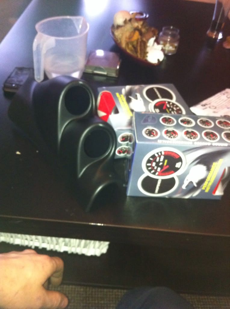

be ordering gauges and pod tonight not sure which yet possibly boost volts and oil temp in a tripple pillar pod possibly just boost and volts not sure yet :-D more as it comes  :tongue:

how do i get on peoples  build threads :-/ 1 thing im sh**  with is computers haha!! i ended up ordering a double pod off dubba d on ebay and 2 matchin gauges volts/boost psi of mcgill motorsport just waitin on delivery of em now!! couldnt find all blue gaiges at a descent price so mine are mixed blue back lit with red digital gauges :-/ £20.00 a piece im not expecting them to even work to be honest lol but we shall see!! should hopefully be here monday the latest!! trying to scrape the pennies together for a set of coilovers!! still a lot on at the minute tho!! main being council tax  :sick: haha

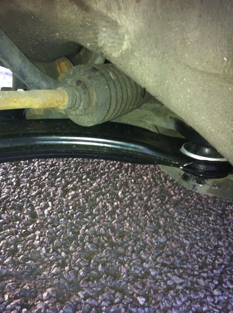

right update from the weekend fitted new lower arm was gonna just change the bush but the arm was totalled twisted bent and chewed and fell to pieces wen we took it out :-s

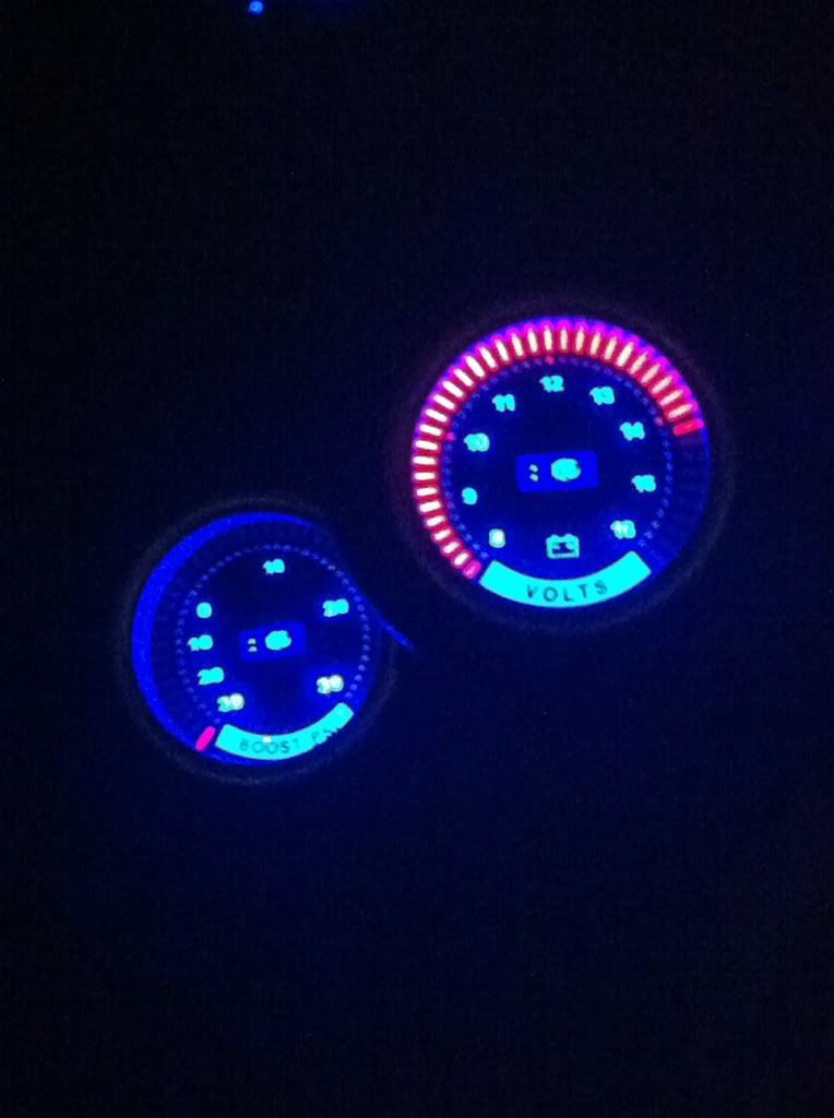

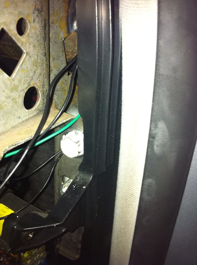

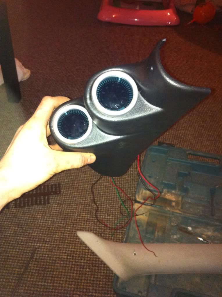

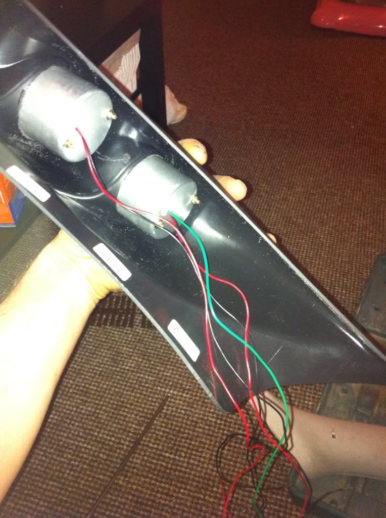

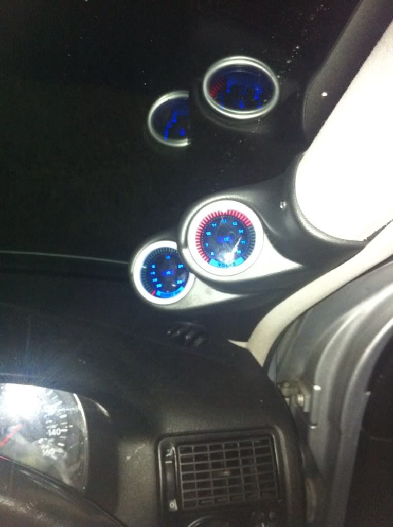

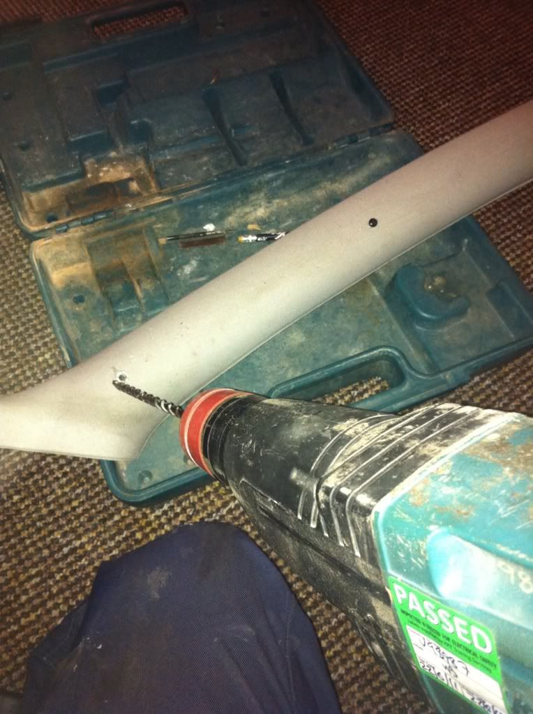

and also my pretty gauges and pod came so now fitted!!!
drilled hole for wires and fitted pod and gauges to pillar, threaded wires through

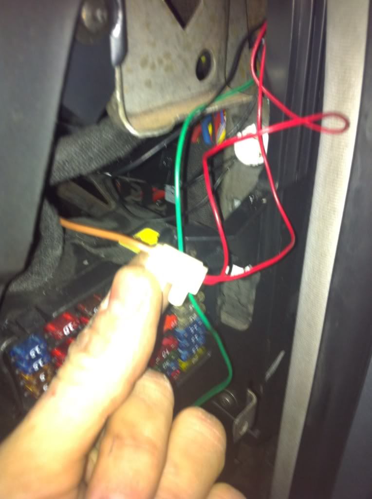

(wire from switch live to choc box)
fit pillar back remove fuse cover thread wires down and link all grounds into a choc box

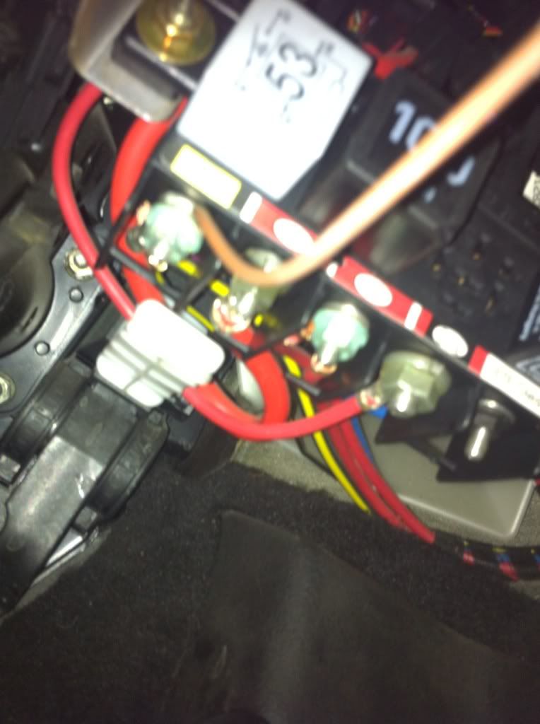

then run a wire from the good switch live think it was 75 (the brown wire in the pic) to a choc box to link in all lives from gauges (my gauge displays are on constant as per fitting guide)
displays then tested

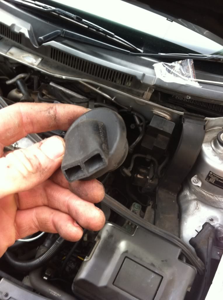

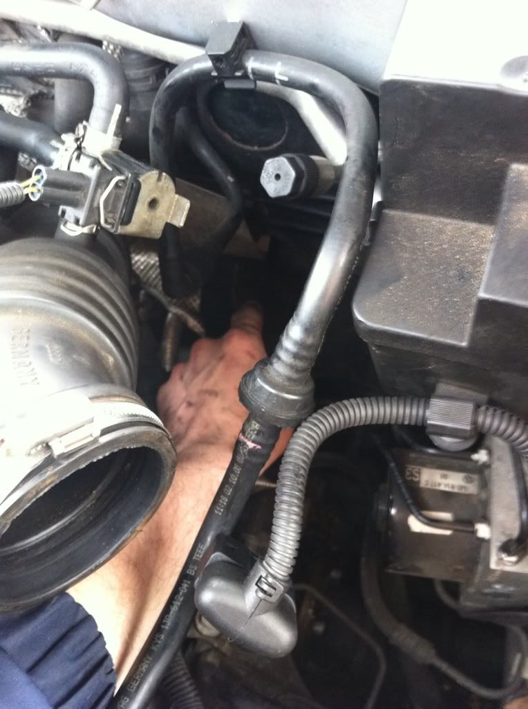

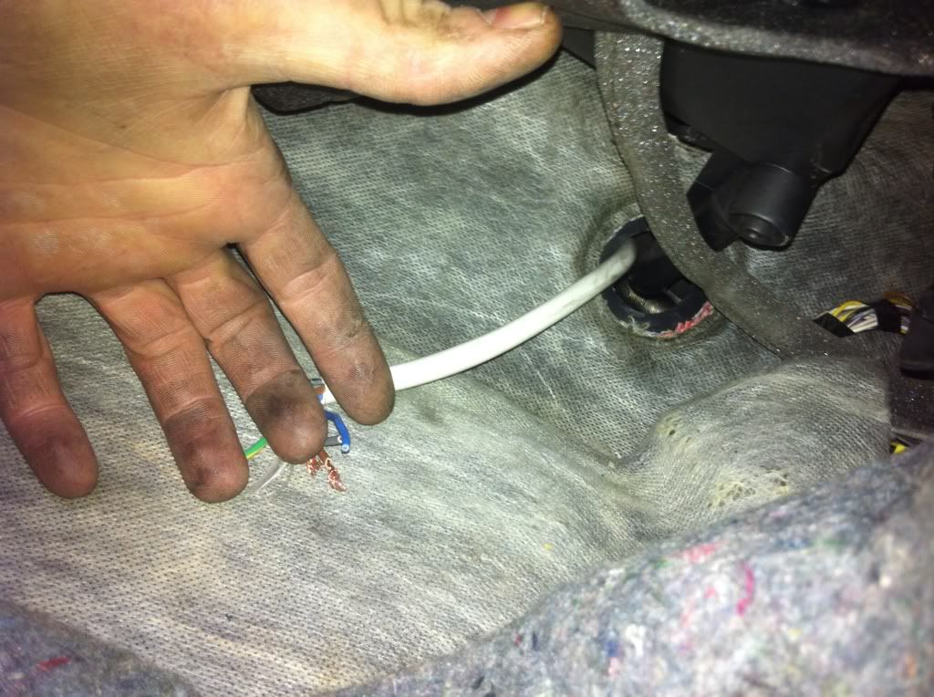

then mostly done other than need ground/12v/and sender wires through fire wall :-( after an hour of hunting and contemplating the drill i found this sneaky russian rubber bung on passenger side!! not good lookin in the dark!!! this was the longest part of the whole job!! finding a hole in the fire wall!!! argggg!! lol all good wen found! here it is!
under the carpet/sound deadening on pass side just to left of center console as you look at the dash and from the inside
from the bonnet  you have to lift the material up!! behind maff/tip etc i removed air box and stuff to get to it easy here it is
no pics of sender cuz i was cold lol basically its a 12v supply ground and sender wire which all linked back to that choc box at the start
and then tee your hose into the fpr which i no need to replace the tubes as there crumbling not a bad job nothin to do with the volts gauge as its just run to a main ign live and is reading the voltage simples

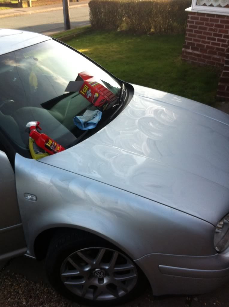

and to top off a busy weekend thought would finish off with a good wash.... clay the car and polish as it was a nice day  :tongue:
recomend the old clay kits looks mint wen finished!! shame my wheels look tired!!! im thinkin wheels next!!!! im dieing for wheels and coilies!!! pennies are tight at the moment!!! :-(
