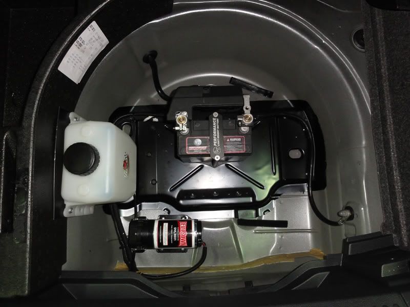

Here is a quick photo of the rear install for the Polo GTI. The pump is gravity fed from the bottle and so has to have it's intake point below the bottle bottom. Luckily on the Polo the boot section is very deep and allows for this. Full credit to Statllers as they made a really neat job of the install and pipework.
Still not fully installed yet as I'm having a custom pipe fitted to house the injector and it has to be fabricated first.  :cool:
