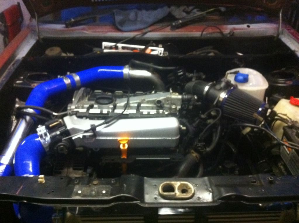

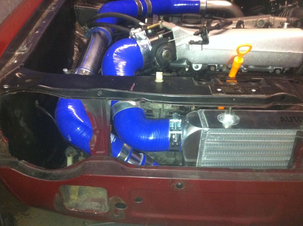

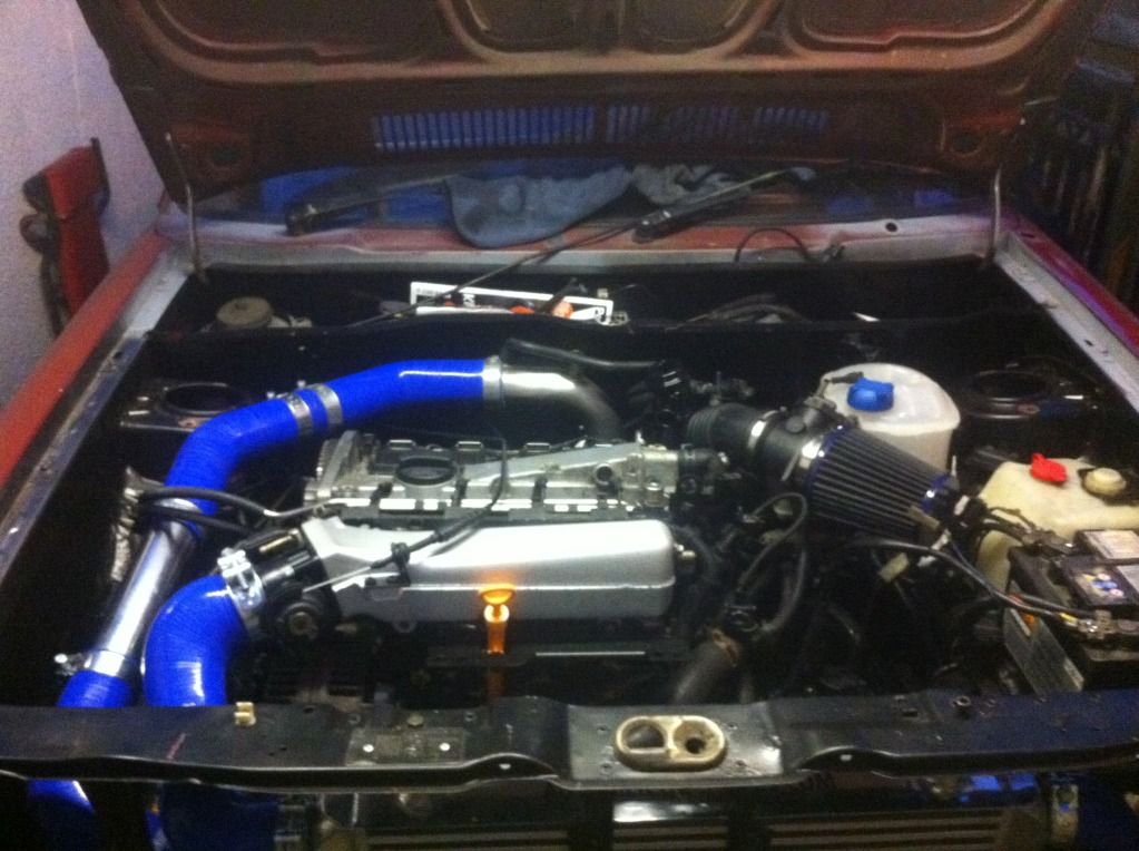

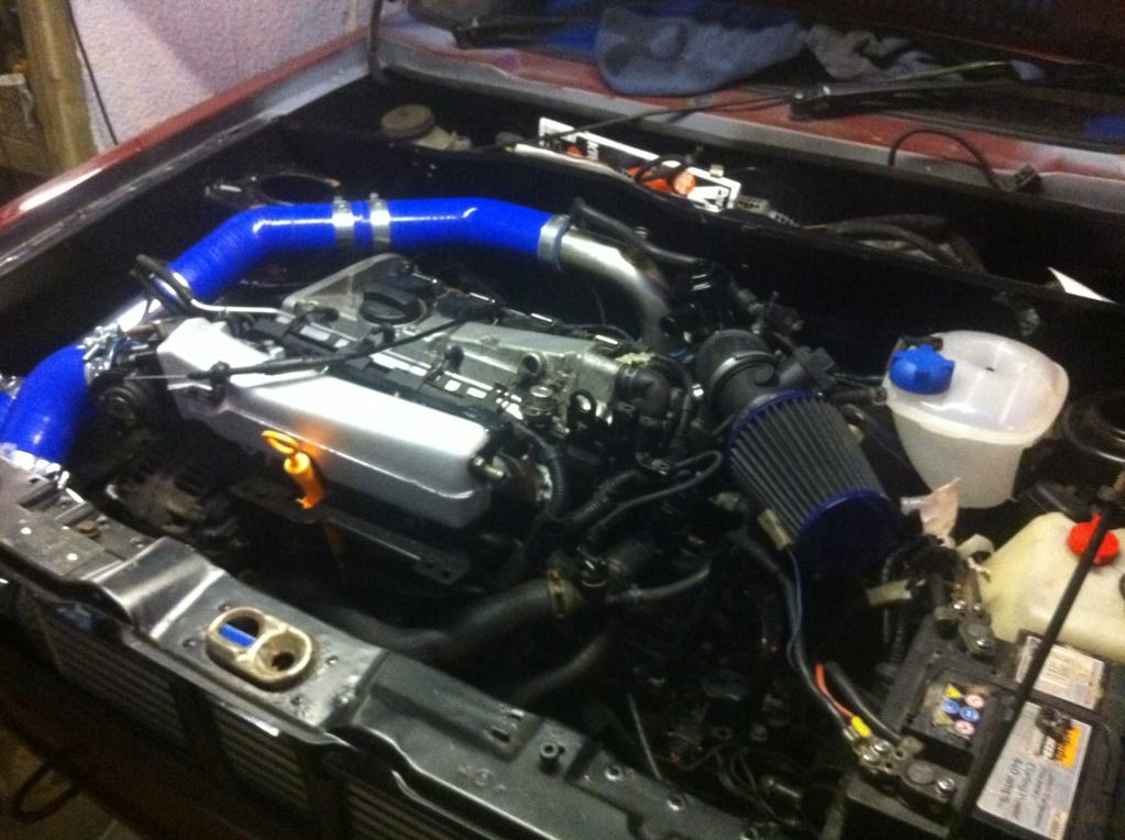

A few pics of how the bays looking at the mo
The charge pipe on the left of this pic needs shortening slightly so as not to foul on the headlight once it goes back in

Not sure a out that boost run.  :undecided:
Is that the only way it can go ?
