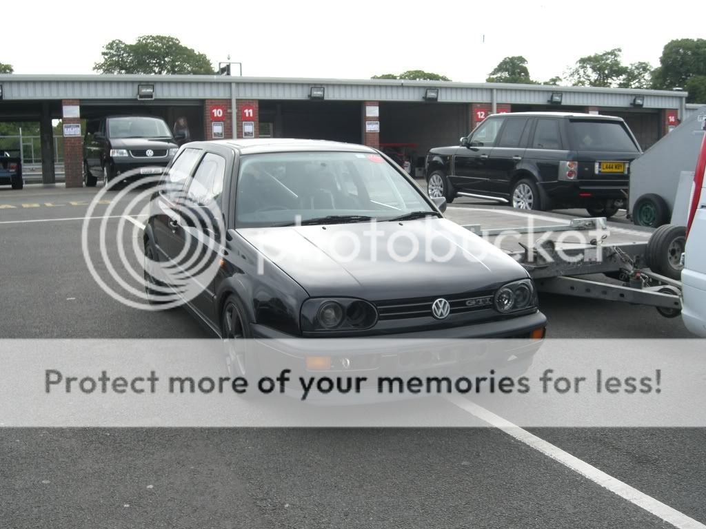

Here's mine to give you an idea its also good to lose the sunroof if you have one, it weighs about 20kg.
I also replaced the windows with poloycarb and lost the bumper renforsing bars.

Your cars looking good Madmanmart, is that a cold air feed in your headlight and if so have you got any more pics of the pipework?
Also do you have bigger brakes / what are they??
