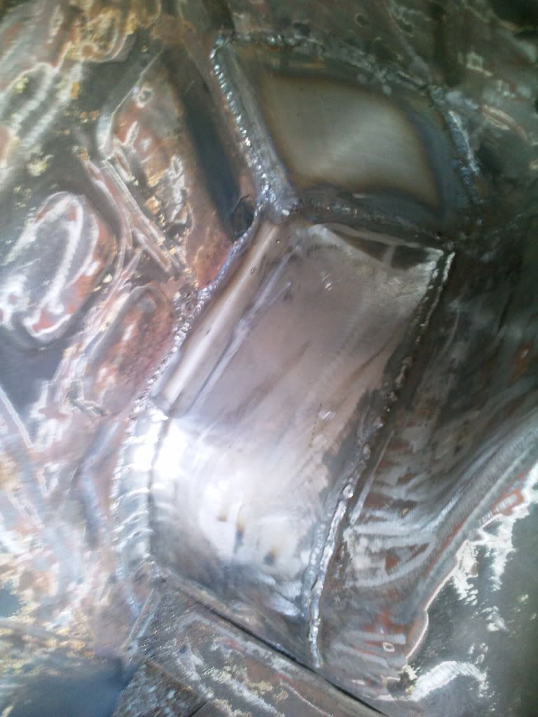

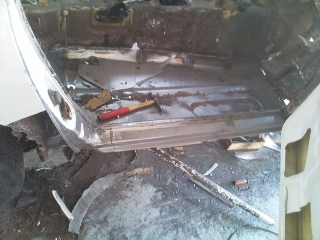

Floor pans are all here to be welded in, will need to weld some of the front bulkhead up also, due to where the battery is orignally located I guess some acid leaked and corroded it, fortunately a flat plate... unlike this one I need to fab up:

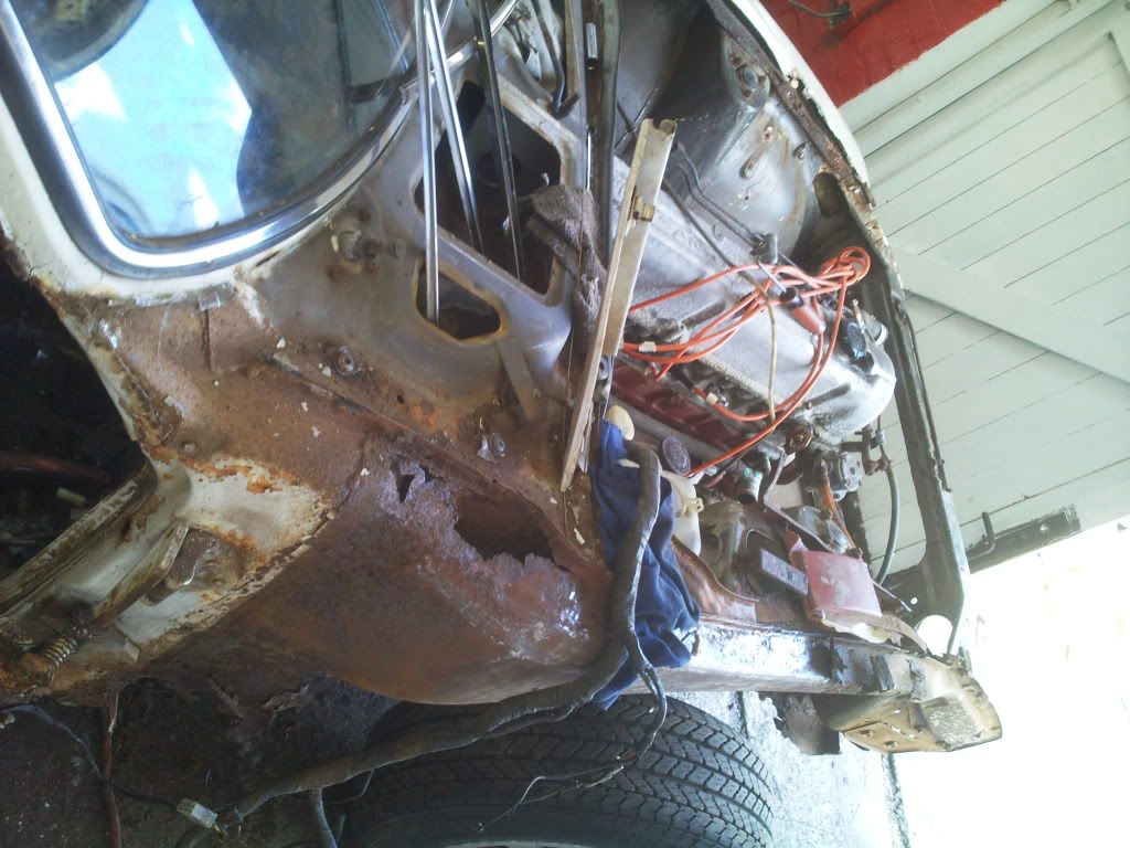

Both front upper legs are pretty bad - you can buy them but I think they are salvageable! They arn't structural, they are known as the air tubes as this is where the cool air from the front of the car is fed into for the so called air-con on the original Z! Still has the little flapper things also!

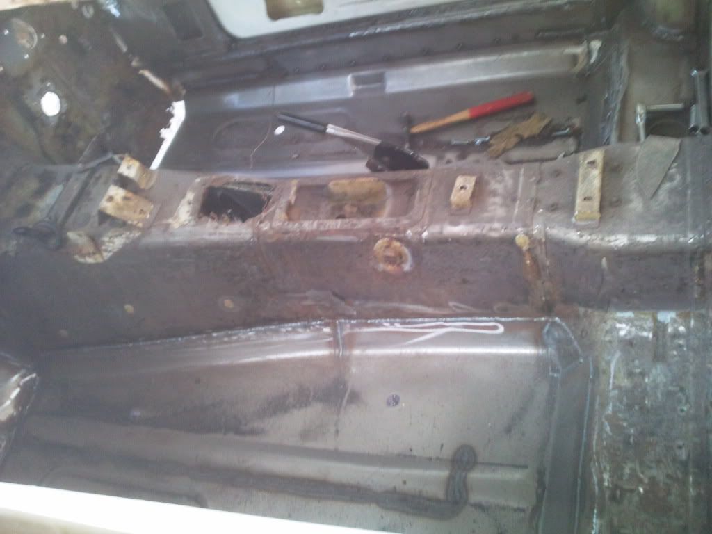

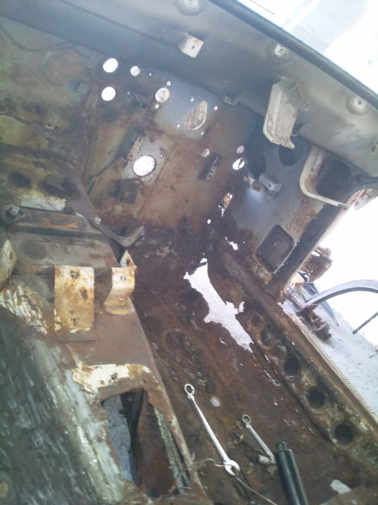

And a rear inside shot:
Started work on the passenger side - floor pan and front bulk head out - got some strength in that before the sill was cut out so the car didn't fall in half [:$] Waiting for that sill to come from America - I do have the other side...in hindsight I should have started on that one....but I was a bit eager!

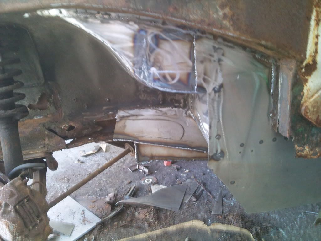

When doing the lower bulkhead I noticed some patches coming through where the battery tray would originally have been...not needing a battery tray in the front anymore decided it would be best cut it out...

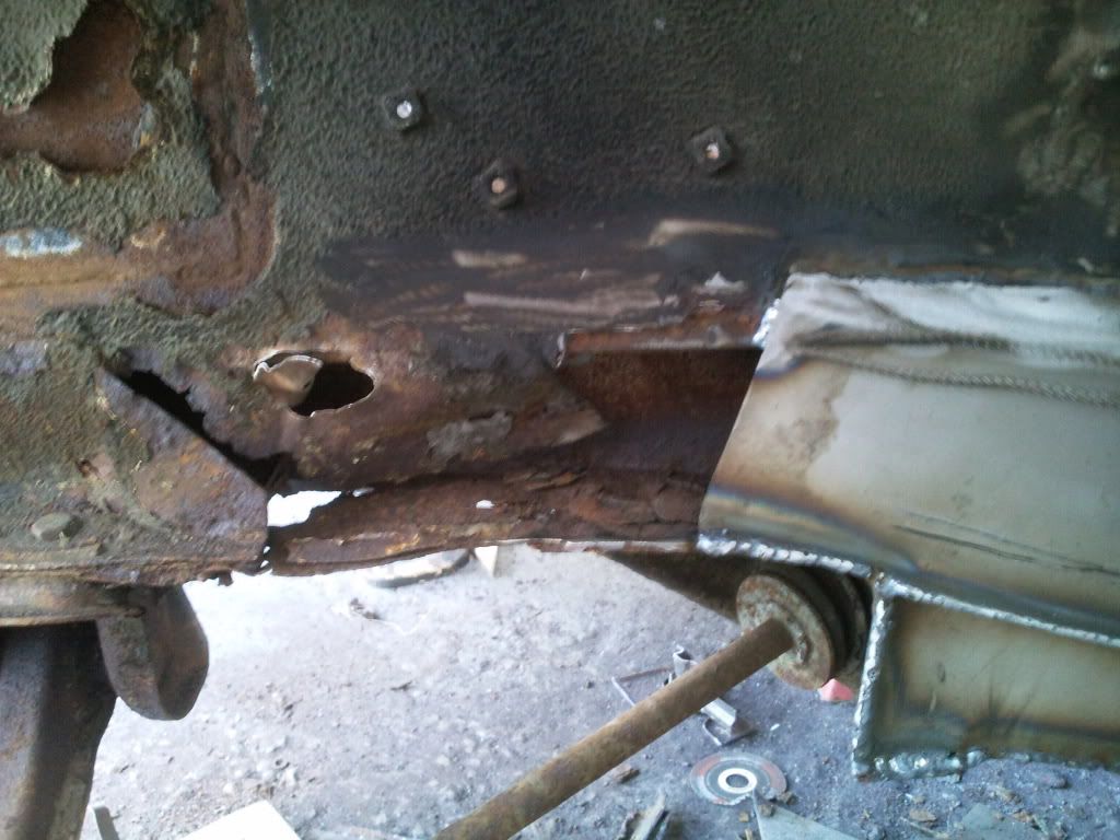

Then started work on the front passenger chassis rail and front sill area- its pretty rotten but the main structure is still there so no need to replace the whole leg - if I had a jig already made it might be worth it...
The worst bit:

Drivers to be done:

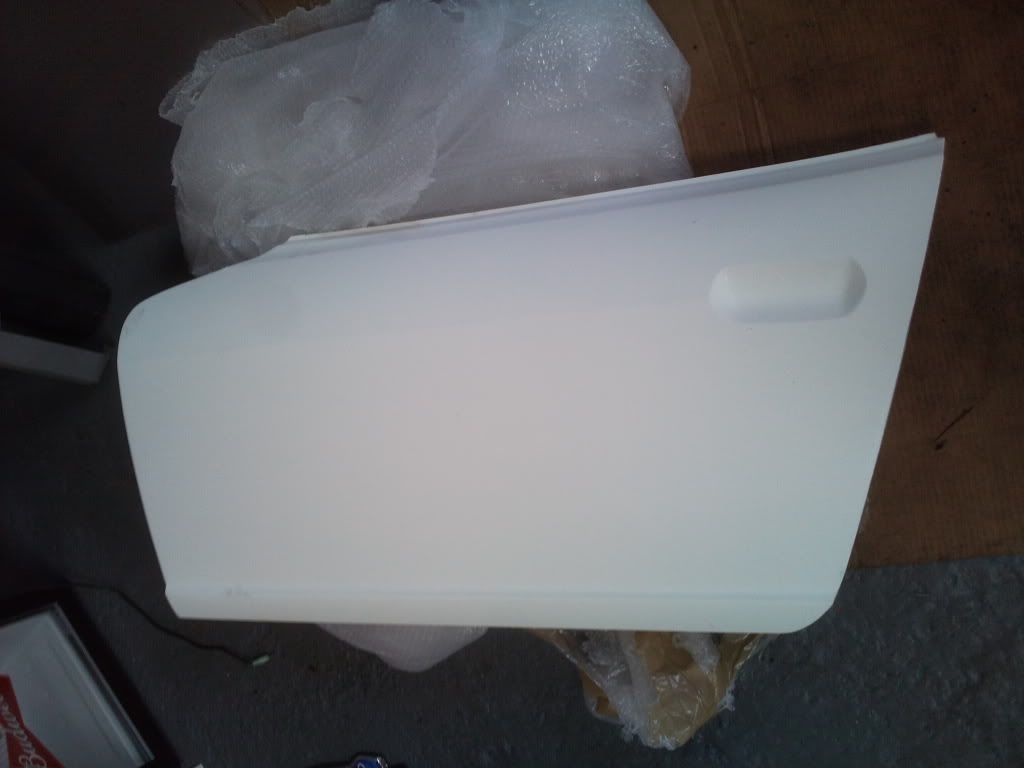

My new light weight doors came and the complete front wings will be here next week aswell so I can line the sills up properly...
They weigh LITERALLY nothing....just need some poly carb windows making up! Can leave that till last though...

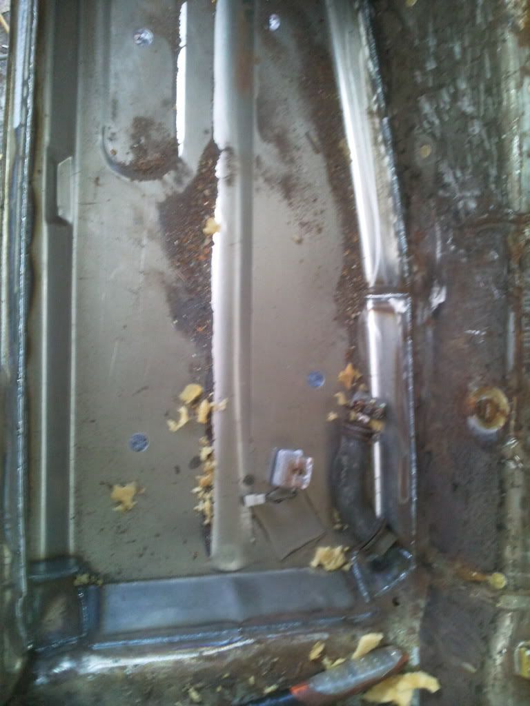

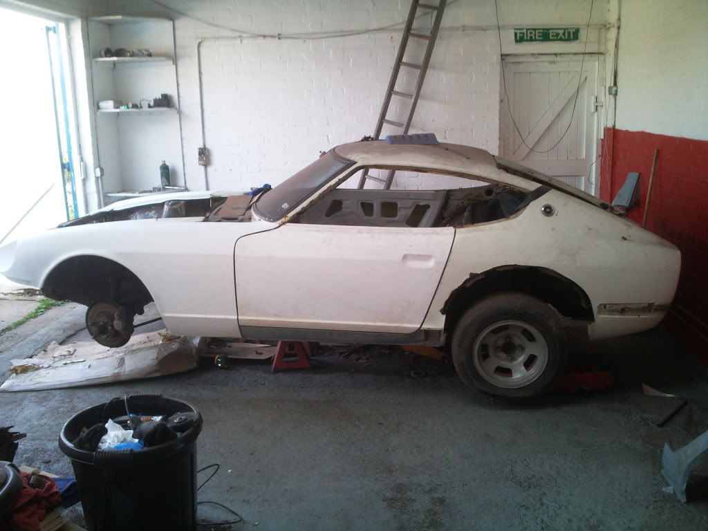

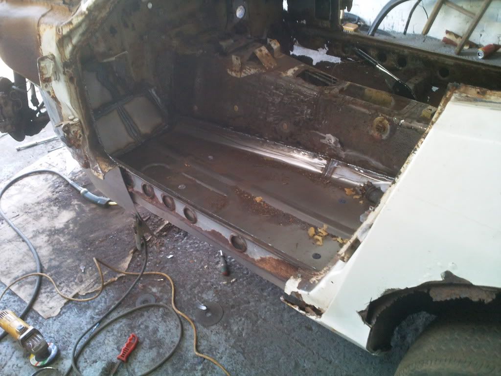

Both sills are now on, floor pans in, some work to do on the drivers front floor pan/bulkhead and trans tunnel...

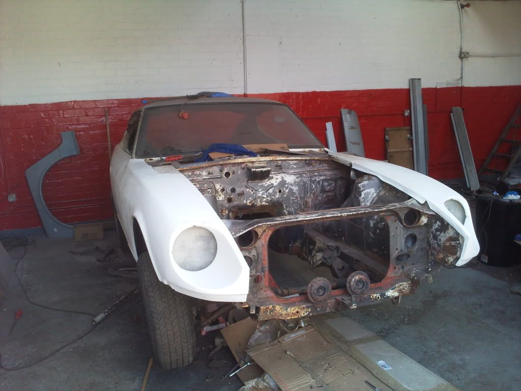

Fiberglass wings and doors lined up roughly, passenger wing needs some work as its too far 'in' towards the door..
Next job is the rest of the frontal floor pan area and the start on the front chassis rails and airtubes I guess...waiting for the inner rear arches to arrive fro mthe states... Nearly 300 quid for 2 half inner arches!
