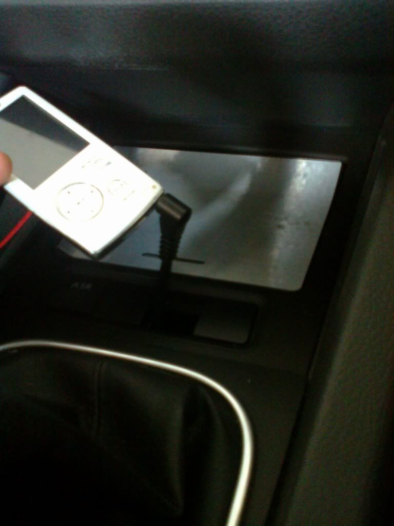

Sorry man I completely forgot about the pictures  :embarassed: I took some yesterday. The little box of tricks plugs into the back of the headunit. I fed the aux input down the centre console and out of the blanks in the ashtray. There's just a hole there at the moment. I had a blank with a hole and a grommet but I lost it  :lipsrsealed:
I find it really easy to reach and change tracks. There's enough length in the cable to bring it close to you. Handy for when the passenger is hunting for a song.

I slide a credit card/id card/any thin plastic card between the edge of the gearstick trim and the ashtray trim. It's very tight at first but if get the card to slide in then you can pull up and forward and it will pop out. It is quite tight at first though.
