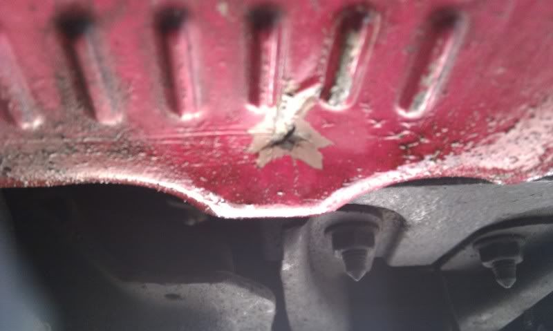

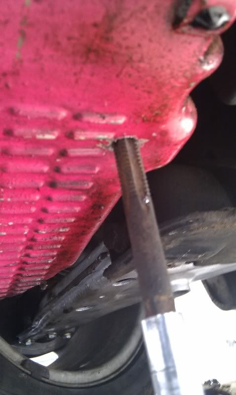

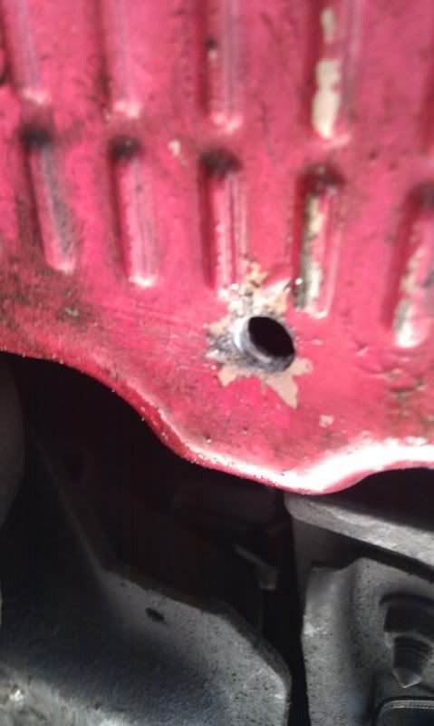

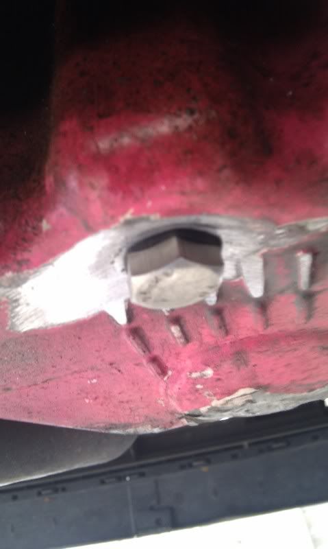

Also I broke the sump.  :rolleyes:
Ruined my paint job.  :cry:
So drilled it out:
Tapped it:
Bolt with an oil seal:
Jobs a goodun. Haven't replaced the sump due to changing the engine soon so not that fussed.

I do hope you flushed that sump out after retapping the drain plug thread? Swarf and big end bearings aren't really friends...
