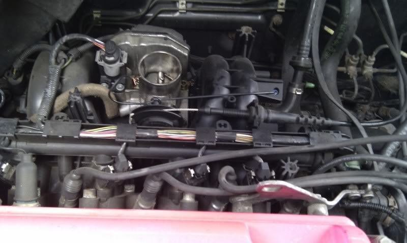

Bottom end knocking and throttle cable snapped on the A2 at Gillingham. Got to Dartford on purely idle clutch, pushing and hills. Finally found a guy at a petrol station lent us an electrical screwdriver, took the airbox off, ripped out a bit of air horn wire and tied the throttle open.  :grin:
45nph in fifth. Will get a pic tmoz.

The fix of destiny:
Got 45MPH out of that.

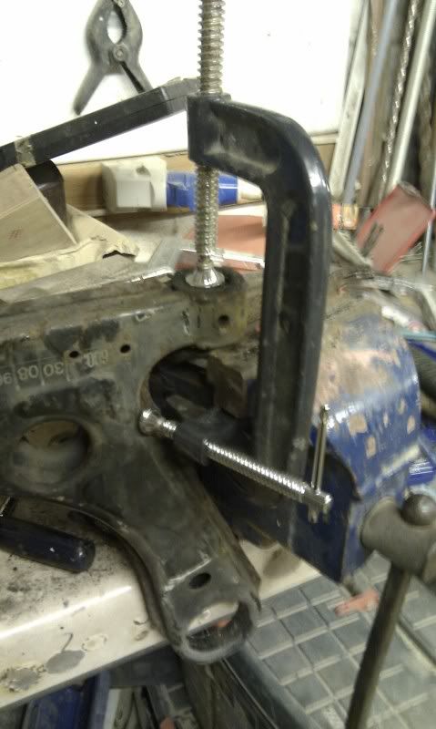

GTI wishbones removed. Blowtorch on the rear bush and a chisle to remove rubber, hacksaw the aluminiumbush ring and tap out.
Blowtorch then hacksaw around the front bush, cut off the overlap then G-clamp:

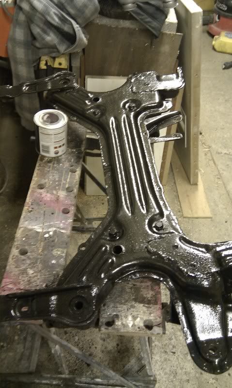

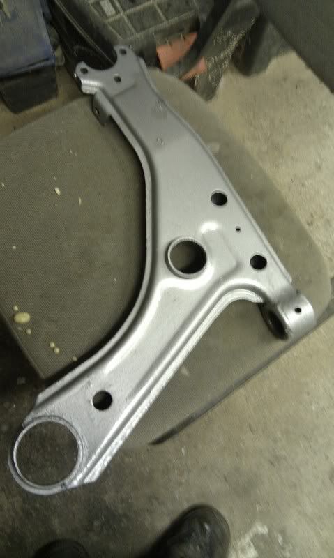

Got the other wishbone off which was stupidly tight, painted them both silver, gotta rub down and do a better coat.
Gotta remove the PAS rack and paint that silver and the subframe black.
Black subframe, silver wishbones and PAS pump, black hubs, silver coilovers, orange springs, dunno about the callipers yet.

Not sure I like Hammered Hammerite. Looking better nonetheless. May grab some Hammerite spray cans and go over it all.

I wouldn't bother with cans over the top, the finish won't change much now its it's been brushed.  why bother anyway, not like its going to be on full on close up display when fitted.
