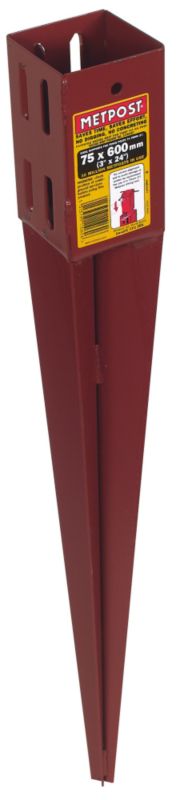

Timber / boards, but hold it in place with some of the smaller size metposts and short timber uprights on the lawn side (for tidyness) to stop the timber moving under weight of soil / shingle.
i like this  :wink:

I used treated deckboard which I got for a bargain price down at travis perkins which is only spitting distance from me, I put them in place using secure posts hammered deep into the ground.. then batoned the deckboard to these... I then backfilled in behind these (using the earth and rubbish I dug up from the patio) and the topped it off using top soil upon which I will sow new grass seed which I am sure the birds will love... the drain I installed has been covered over with pea shingle in front of the deckboard so that it provides ample drainage...
