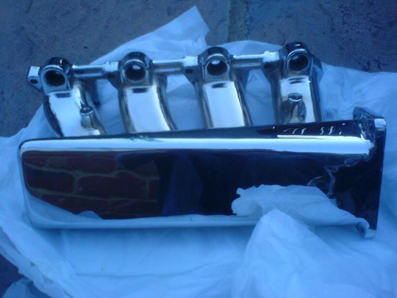

oh yeah also picked up my rocker cover and inlet manifold. not 100% happy with them but for the price they are great, alos the imperfections will be hard to spot when fitted so i'm not too bothered. p.s. they were a bargain!
