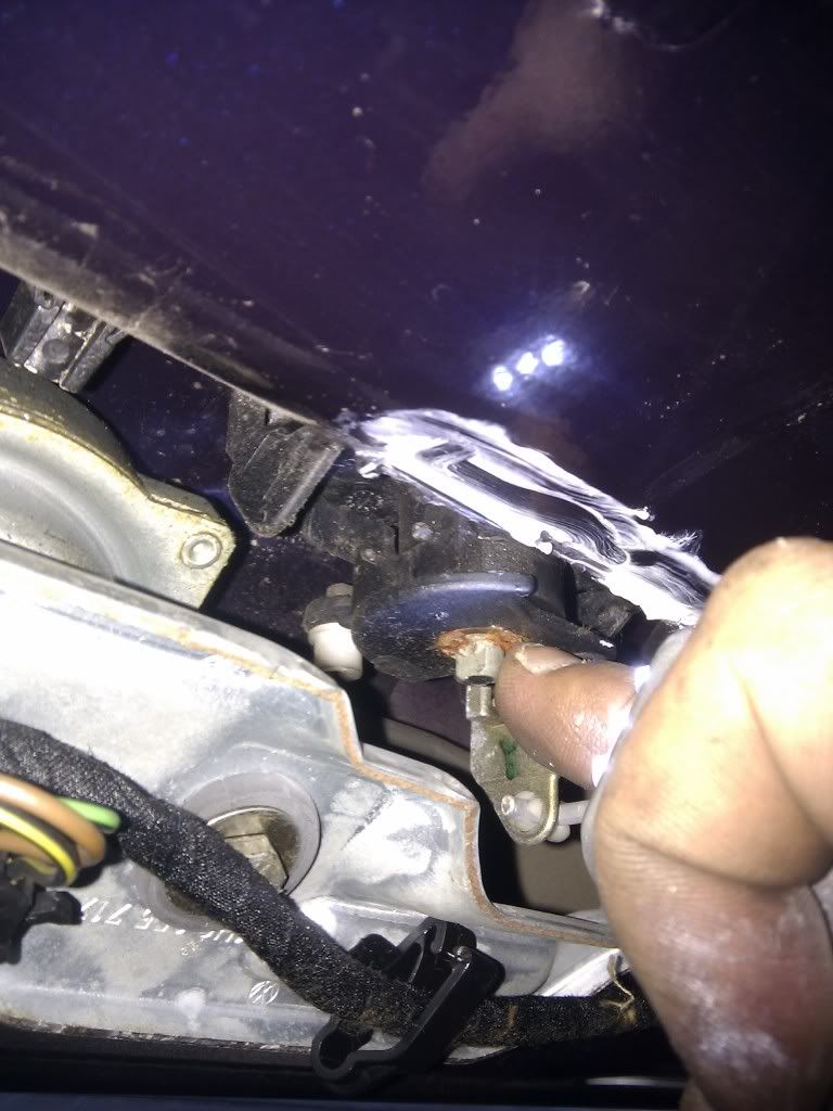

Got a pic of the inside.
Right, this is the lock without being pushed out....
And this is the lock being pushed out (as it should)
On the first pic you car see the O-ring is not sealing the lock. On the second pic, when I'm pushing it up, it seals it. I feel like there should be a spring somewhere, pushing the lock outwards...

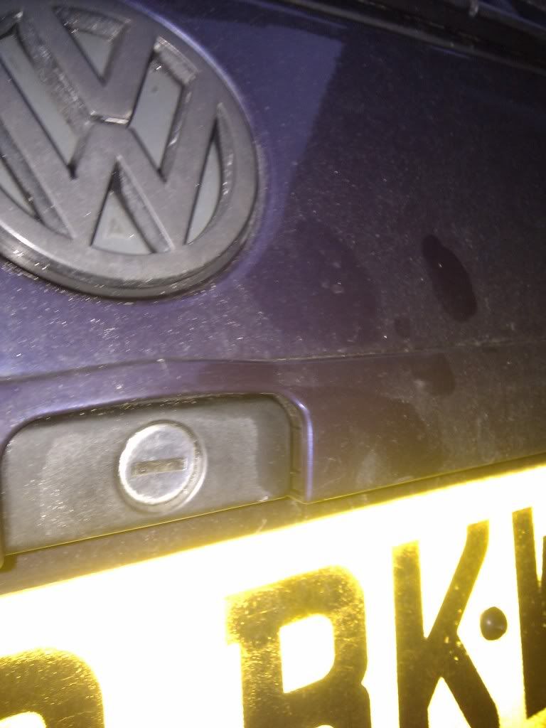

This is the outside view
As it is
As it should be

ah, that would be the springs inside the boot button are fecked. get to the scrappy, steal a complete boot button. pop the old lock cylinder out of yours, rebuild it and swap over. need a cl one if yours is though, i believe they are different
