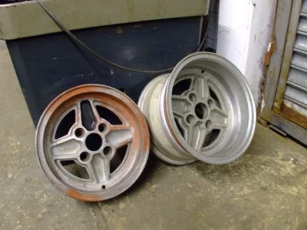

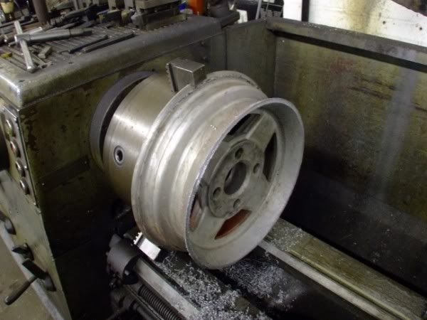

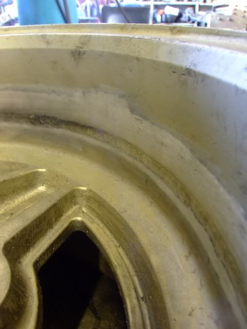

Here is a few pics of some old skool ford alloys being banded from where i learnt how to refurb alloys, they had 2.5" extra added to them  :grin:

Personaly i don't see the point in Xraying the weld on a banded alloy it's way OTT
where wheels fail is around the spokes ether hub end or rim end.  the actual rim itself is very strong compared to the spokes when you consider the way the loads are being placed on it.
if the guy that welded it was crap at welding it wouldn't stay up due to weld porisity issues,  if the weld isn't porus and has full pentitarion it will more the sufficently strong
the edges of the rim however are quite highly stressed and ofer potential for catostropic fail but there not welding there.
if getting keen and wanting to check the weld  a dye and developer would be more than sufficent
In what way is it OTT? Its standard industry practice for safety critical items like this. Crack detector penetrant dies tell you nothing about the depth of the weld penetration or the inclusion of voids/ impurities that will lead to weld failure/internal crack development due to high frequency cyclical loading on a part such as a wheel. Nor will they tell you anything about the condition of the materials in the heat affected zone. If it wasnt such a safety critical area then I would agree with you but I for one dissagree with the safety of welding aluminium road wheels or motorsports wheels without testing them properly afterwards.
