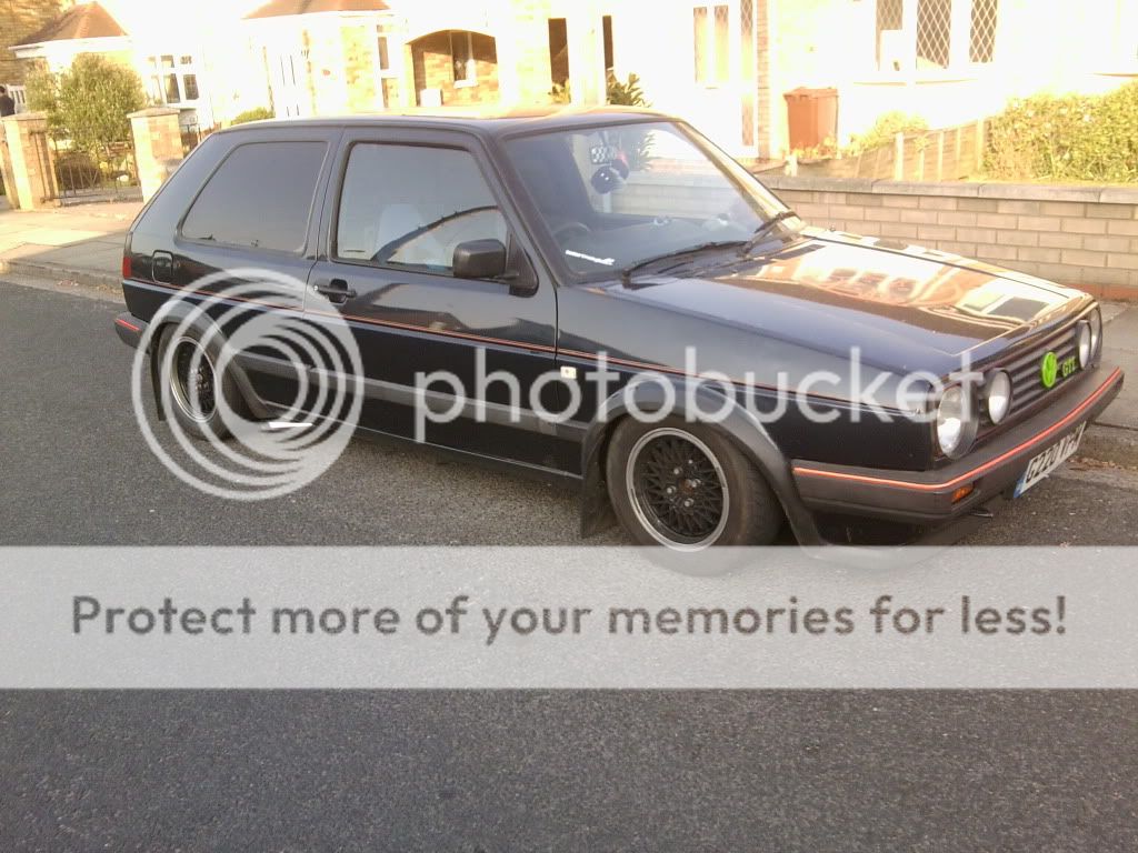

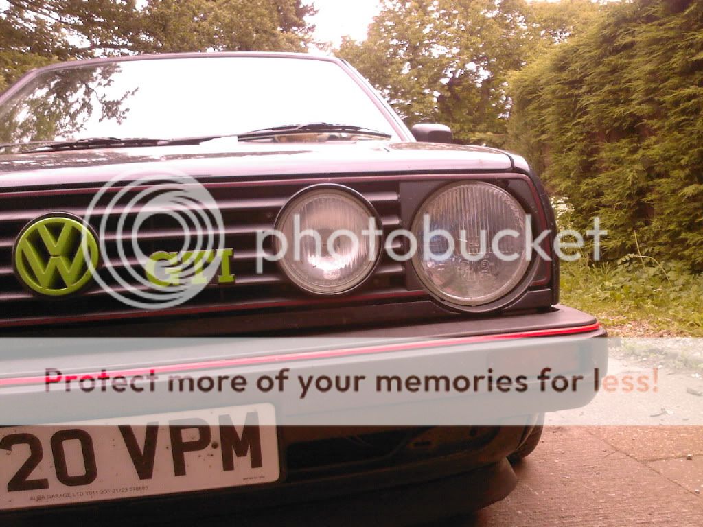

havent been on here in a while but i have finally got round to updating this
firstly,GTI !!!!
conversion took 6 days in total,including swapping all the brakes and brake lines.rewiring the whole car and swapping the engine.
WARNING:ANYONE DOING A DIGIFANT CONVERSION,CHECK THE EARTHS ON THE ENGINE AND GEARBOX CAREFULLY OR YOU WILL FRY AN ECU.

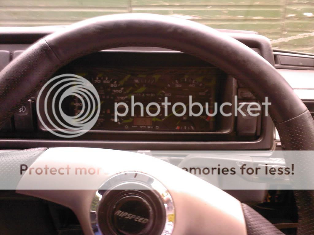

fitted my customised 140mph clocks,also the steering wheel isnt ripspeed but the horn button is.
also random picture i quite like
