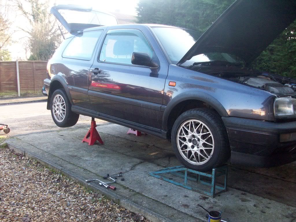

Pre MOT checks carried out and all looks good apart from the exhaust. Got her up in the air today so that I could have a really good look around:-
The cat to centre section exhaust coupling didn't have any bolts in and was free to move around and blow :huh:
I have some replacement bolts so that was an easy fix, however.........
The rear box is still original and the forward part of it, forward of the subframe is cracked and blowing. I've decided to bite the bullet and have ordered the two replacement exhaust parts that replace the one part that goes over the subframe. Should be ready for picking up on Monday along with associated couplings and hangers.

Both sides appear to have a cap missing along the length of the sill trim as can be seen in the photo above. Am I right and is it something that I should be able to find and replace easily :undecided:

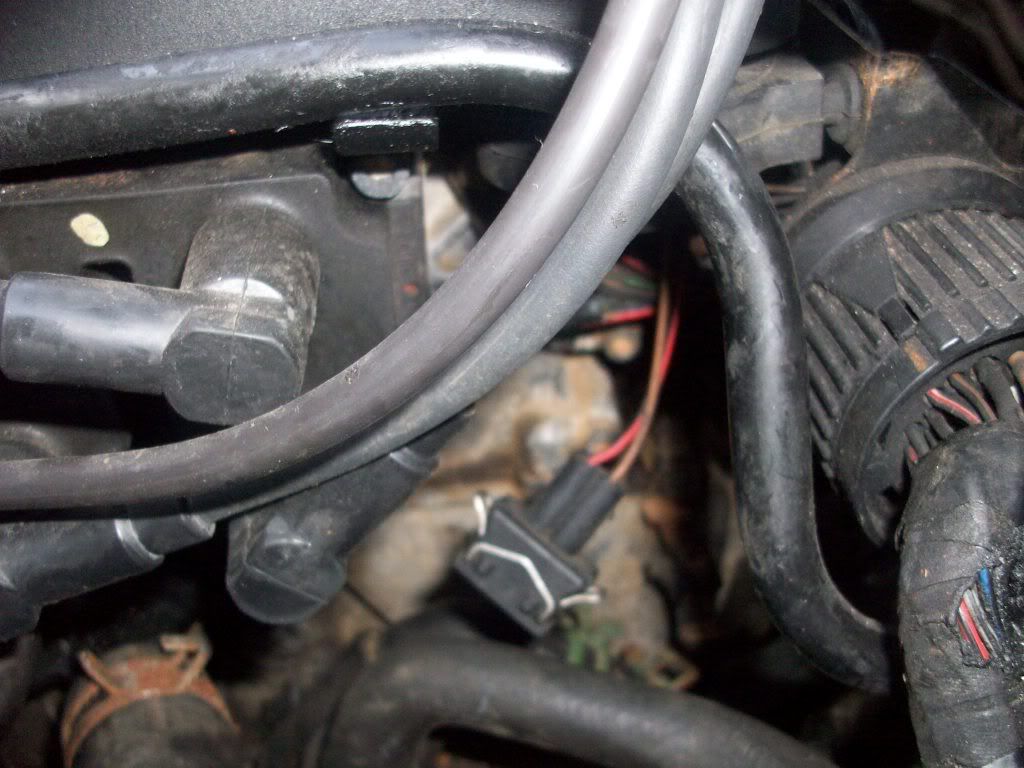

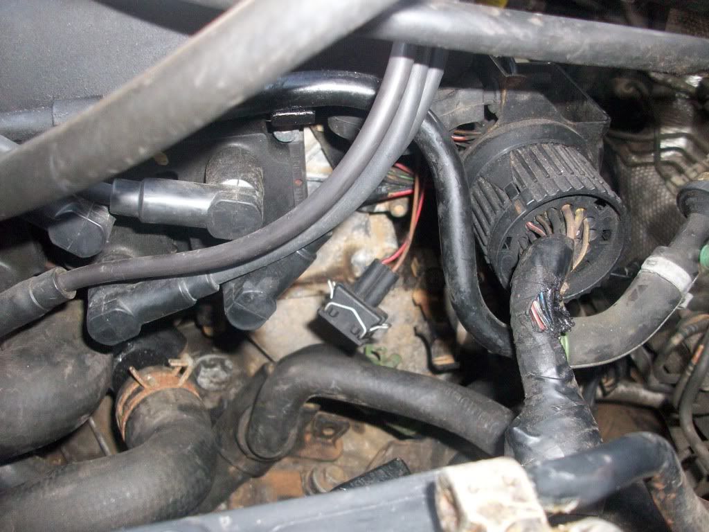

There is a disconnected connector in the engine bay that I can't find a home for, is it meant to be disconnected?:-
