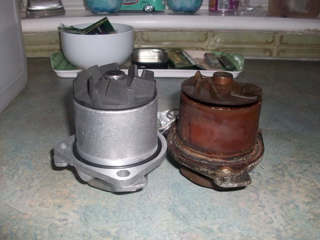

Water pump finally arrived! Can you tell the difference between old and new:-

Can you circle the new one, not quite sure which is which.....
The replacements veins are much thicker than the old one too!?

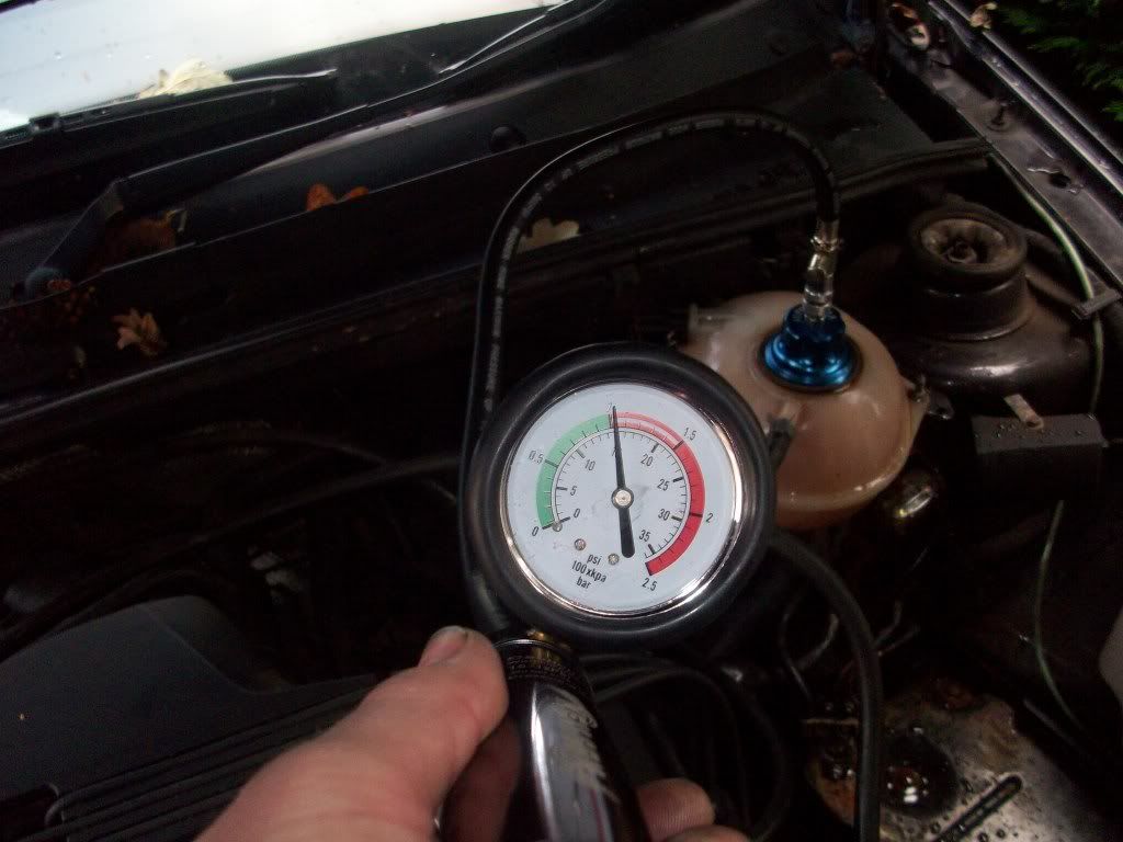

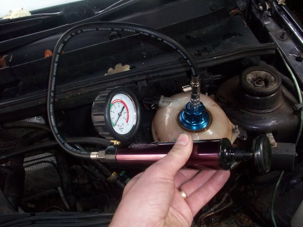

Cooling system back together this afternoon so I decided, before start up, to use this pressure test kit that Corin lent me:-
So found the correct adapter for the VR6:-
........and started pumping:-

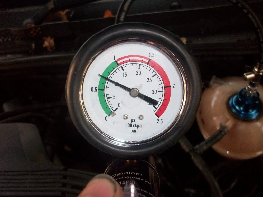

Got it up to 15psi:-
........and the pressure was dropping quite quickly :cry:
I had a look around and found two leaks, one from the thermostat housing and one from the drain plug in the transfer tube.
Took the radiator panel back off, thermostat housing back off and fixed the leaks.
Re-pressurised and this time, much better. Just a couple of smaller leaks from two hose connections.
Replaced the jubilee clips and its now holding 15psi for at least 5 minutes :smiley:
