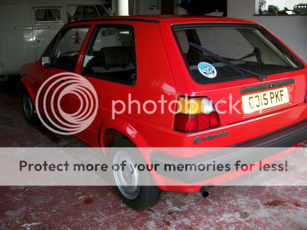

As some of you may have seen in another thread my dad has just bought a very low mileage mk2, theres a couple of things that he's asked me to sort on it though.
Firstly headlights are sh!te so i'm making an uprated wiring loom for them.
Secondly the rear screen heater works but takes about half an hour to just demist the window, is there any way of improving this?
Finally, it looks to me as if it is missing some trim from the doors, can anyone confirm this?
Here's a pic of the car, you can just about make out a little bit of trim infront of the rear wheel arch:
If you compare this to one of Chuff's old ones, the trim should continue along the doors?

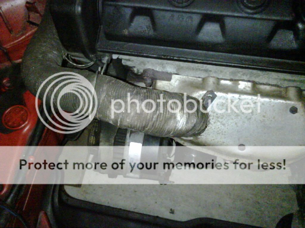

Secondly, having a poke around the engine bay I came across this:
Which looks to me like a homemade pipe, what is it for and should it look like that?
Cheers  :smiley:

Centre caps - maybe, but the black ones look fine
Pipe - its a feed to provide hot air up into the air filter box - it is just old - new BLACK ones can be had in meter lengths from GSF and the like

side trim, sure the base models came without, looks fine

I'll get some more piping sorted and leave the other things for the moment then  :smiley:

Those are the centre caps on the wheels.. a little black thing over the hub cap and some black plastic caps over the wheel bolts
The bit of pipe sucking hot air from the exhaust into the air box helps stop the carb icing over when you're flat out
