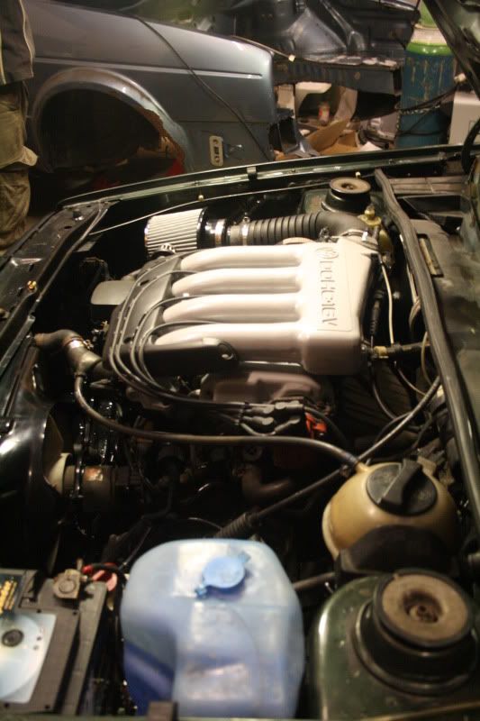

« Reply #28 on: 02 January 2011, 02:28 »
Finally finished this conversion today, my mate has now collected it and driven it 150 miles home and all seems well apart from it takes a while to return to idle .. drops to a about 2k revs then stays there briefly then slowly drops to 800rpm. Believe this is likely to be the ecu water temp sender ? so will get that changed soon :)
