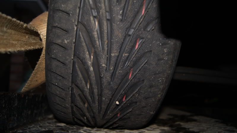

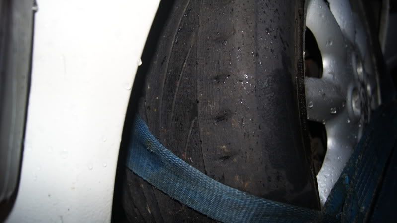

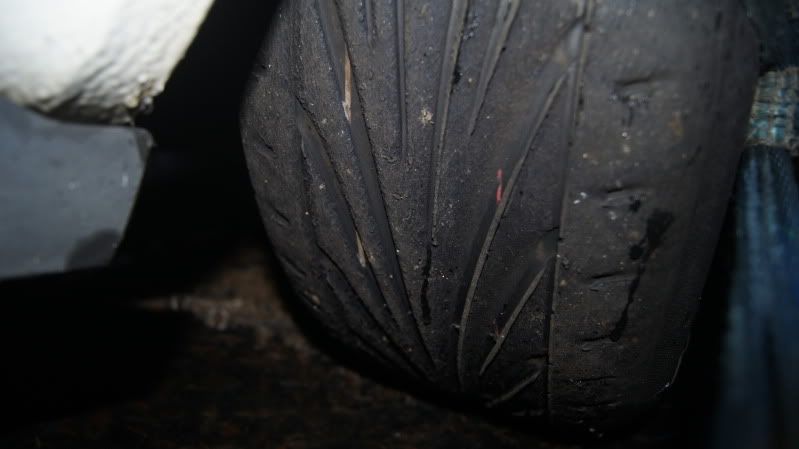

i found the proxies quite good in first 2 sessions but they gave really bad understeer in the 3 rd session il get a pick of them later just to show u how bad they got chewed
I'd be interested to see them.
A few questions - have you had the alignment done? What tyre pressures were you starting off at? Were the tyres new or already part worn?
Paul
Offline leeroy20vt
  • Posts: 1,951
  • h reg mk2 gti
Re: Last trackday of the year
« Reply #16 on: 22 November 2010, 15:56 »
we started cold at 24 psi when hot they were around 29 psi not sure if that was to little or to much
they were very slighty warn hardly any think tho still had pimples on
we had 4 wheel tracking and thats it
drivers side
passenger side which was the worst side to
« Last Edit: 22 November 2010, 15:58 by leeroy20vt »

 :shocked: :shocked: Surely they aint supposed to get like that? Probably need the whole geometry setting up or more air in em?  :huh:
not sure m8 the avons didnt wear like that no were near as bad mayby pressure is to blame
the car doesnt pull ect so it cant be that much out the only thing i could have done is camber i sopose

Need more negative camber and you need to control your understeer more. You'll go faster and wear your tyres less. Also what was the surface? Airfields are much harder on tyres than proper circuits due to the rough and ready concrete.
