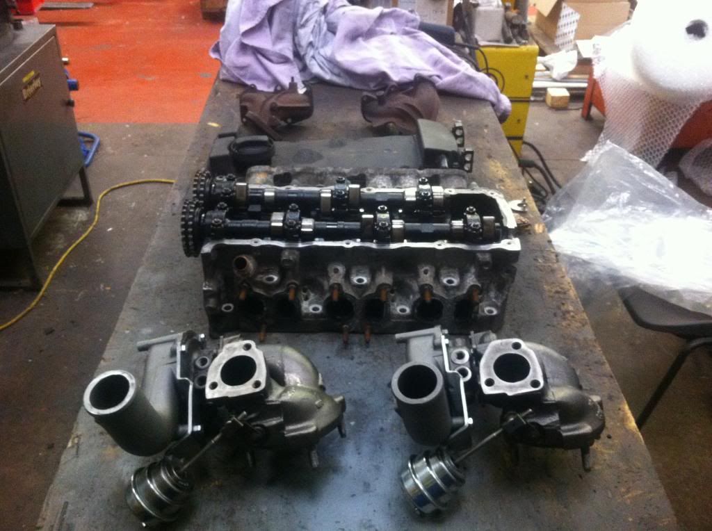

Ok, I've picked up my new engine, gearbox, got both my turbo's re-furbed, other bits and bobs, 2 x smic with some pipework, so thought I would sling some pics and ideas up
First up my turbo's next to my head that I'm stripping and porting

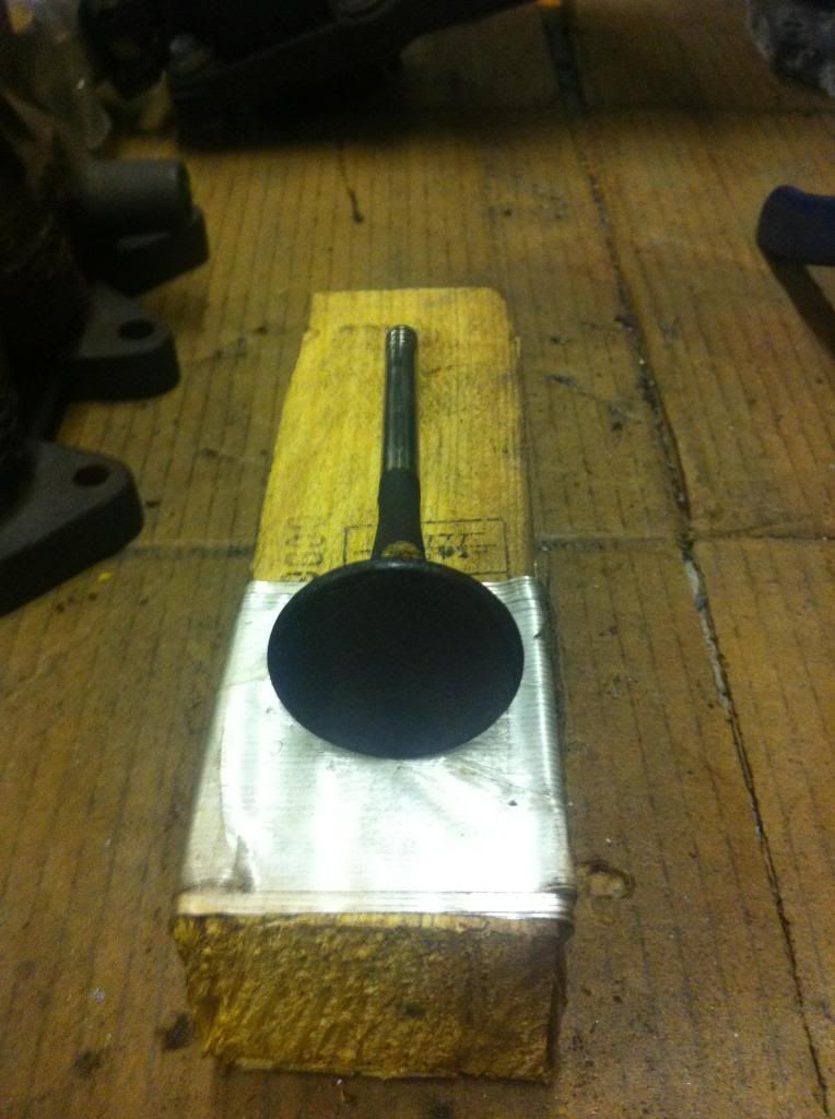

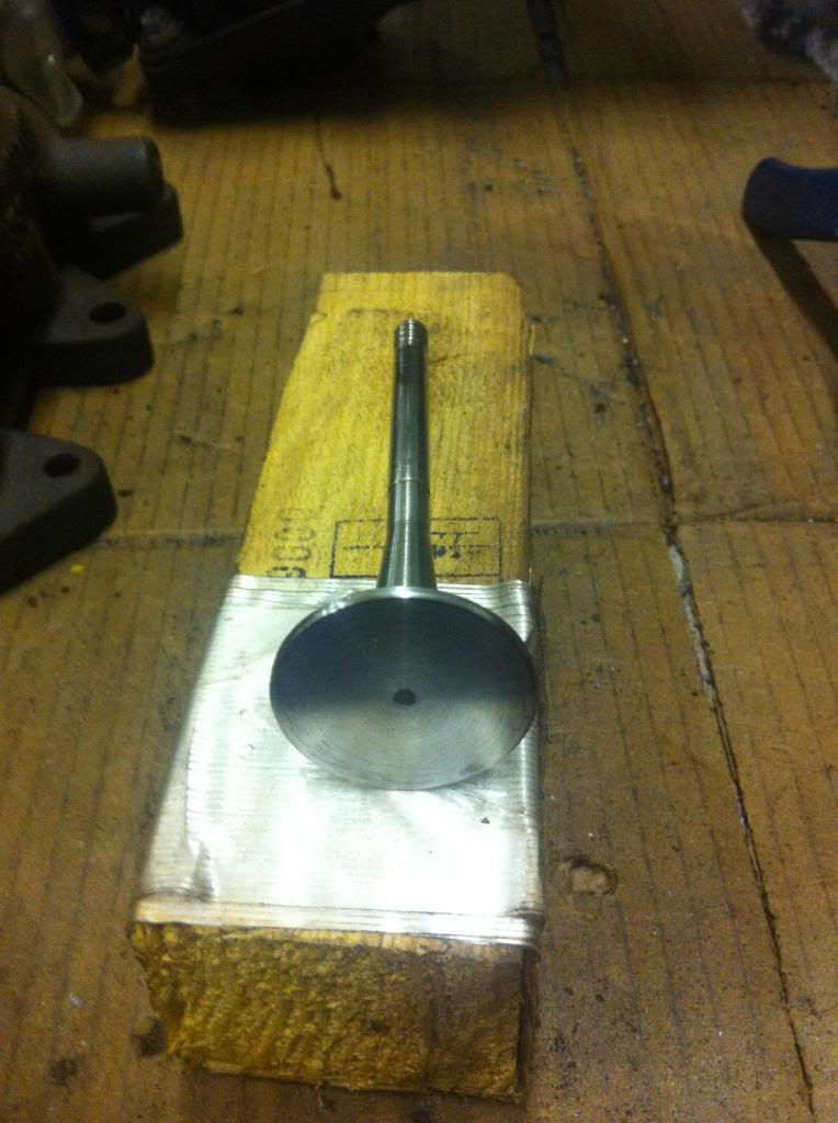

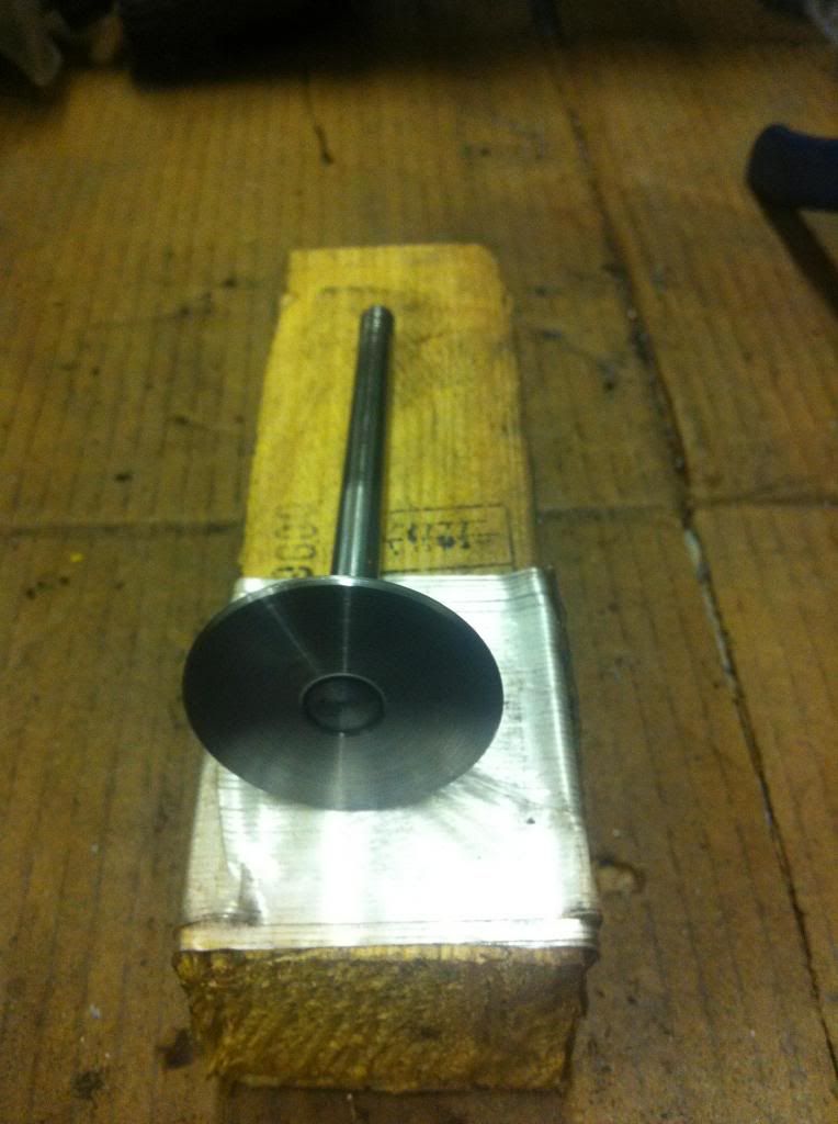

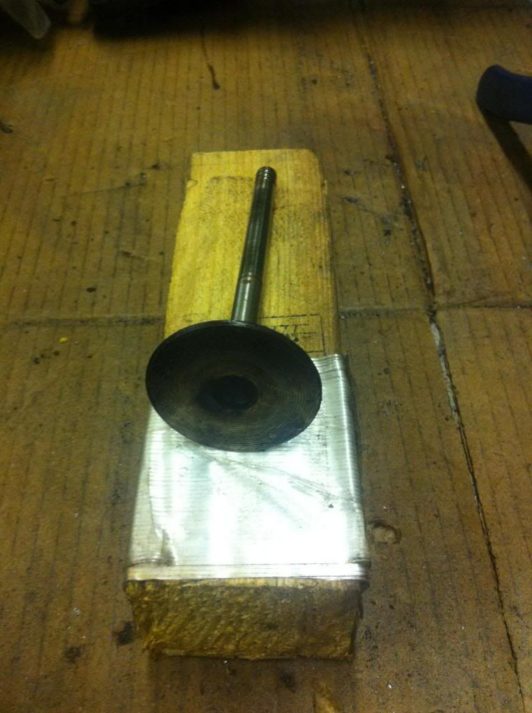

I removed the valves from the head, which is from a 70,000 miles auto so is pretty mint anyways, and give them a damned good clean and polish
Went from this
To this
And this
To this
Hhhmmmm pretty!!!  :tongue:

I will be fabricating my outlet manifolds up over the next few weeks, once I have the flanges lazor cut I will then port match the head to the flanges and polish em up nice an shiny. Gonna make 2 x tubular manifolds so one turbo per 3 cylinders  :smiley:
I think I've worked out the pipework routes so I can leave the bay looking pretty oem......ish, I want to keep the original plenum but the original air box will have to be removed so will be running a cone filter, everything else should stay exactly where it is  :cool:

Think you're gonna struggle for room with the standard inlet on, whilst running boost pipes to front of car then back on themselves to enter TB at back of engine. Plus the long runner manifold isn't best suited to FI.
Although possible, won't be the best to work on.
