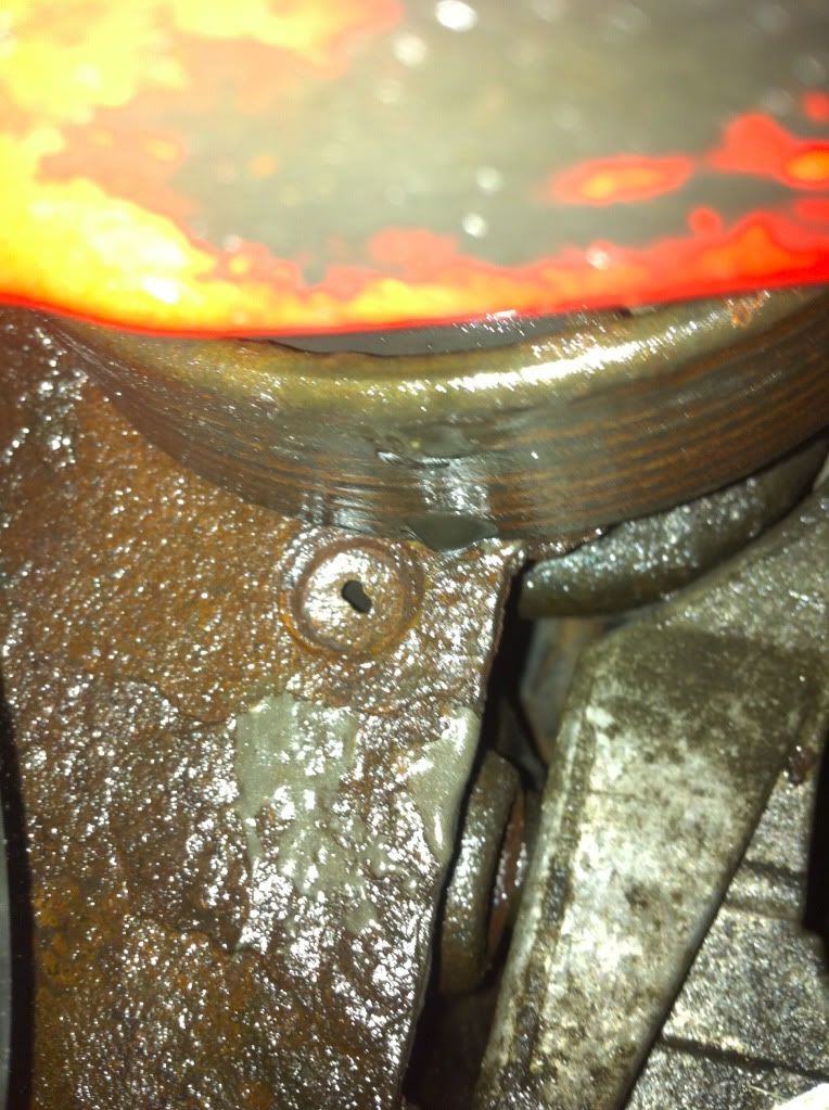

WELL...................... Its been an eventful week  :cry:

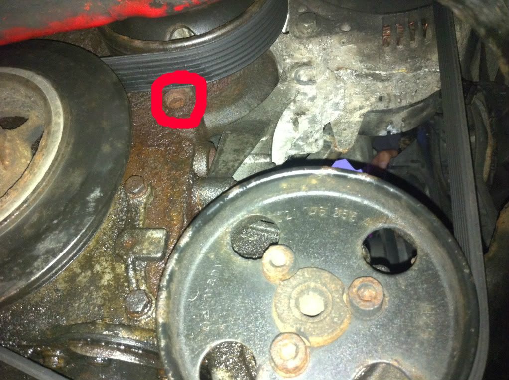

Noticed a small oil leak on the VR when the engine was running, on closer inspection it looked as tho it was coming from behind the P/S pump  :undecided:
Anyways, last Wednesday took the front end off the car (AGAIN!!!) gave it a good wipe down, started the engine and had a nosey about.
After a minute I see the drip again so follow it up the block to the oil gallery plug just under the coolant pulley.... its seeping oil......BAR STEWARD!!!!!!!!

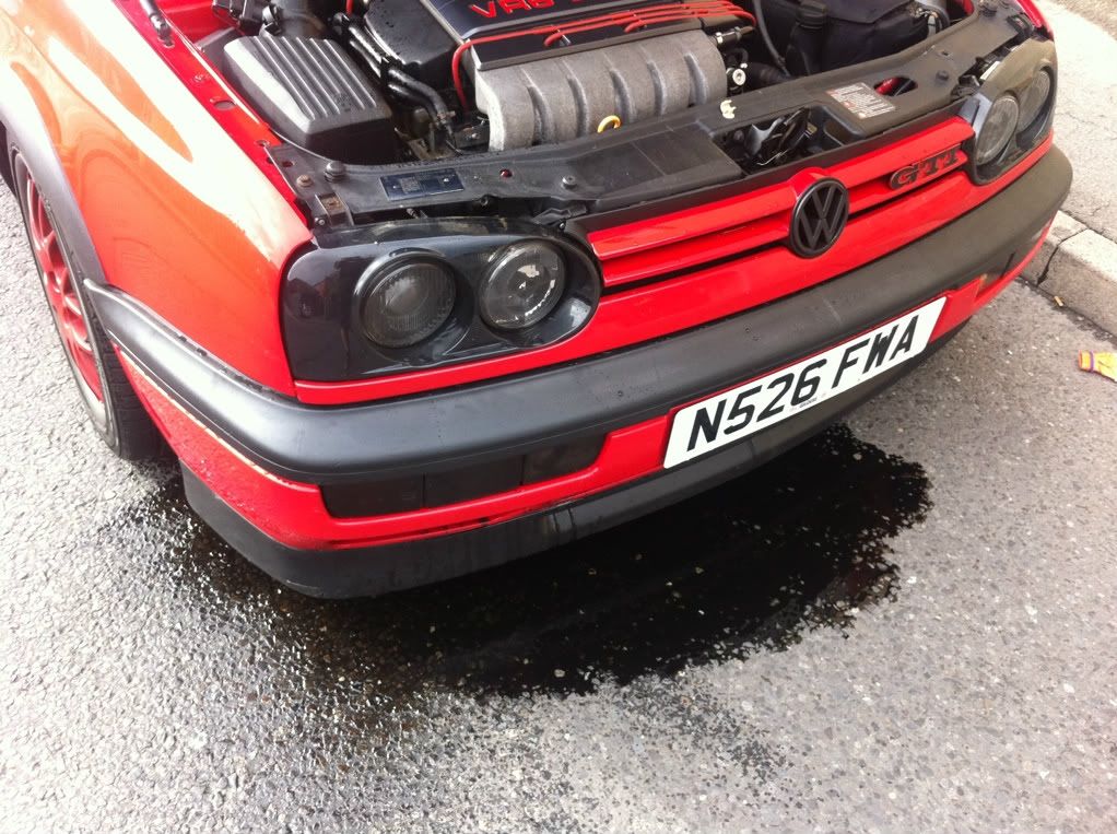

Set off from work on Thursday night, got about 100 yards and ppsssssshhhhhhhhhh
OIL EVERYWHERE!!!!!!!!!!!!!!!!!!!!!!!!!!!!!!!!!
Had to get recovered and once home discovered the liguid metal had somehow punctured a hole in the Oil gallery plug
So, VW let me down on Monday, fecking useless!!!
Turned up yesterday so me an Kells had a stab at putting right, managed to get the old plug out with no real issues, putting the new one in..... another story  :angry: :angry: :angry: :angry: :angry: :angry: :angry: :angry: :angry: :angry: :angry: :angry:
After lots of swearing and pissing about managed to get it in the hole (oo-er missus) filled her up with oil and started her up.................... Started seeping oil F*CKING B*STARD C**T TW*T SH*TE PR*CK B*LLOCKS
Tried to tap it in a bit further but because you cant get square on to tap it into position properly, I made matters worse, the plug went pop and I got oil in my eyes, mouth and nose.. EXCELLENT.
Me an Kells searched high and low for the plug but couldn't find it so abandoned it all :cry: :cry: :cry:
Kells went home, I came in the house, emptied my pockets and found the plug  :shocked: :shocked:
It was cream crackered tho so ordered 3 from VW today so should be here tomorrow.
Ive made myself a little 'press' that fits between the plug in question and the chasis arm with a thread on it so I can push the plug in square and hopefully solve this little debacle  :wink:
