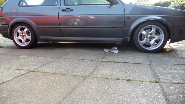

Got some MOT wheels for now but here are a few rare shots of the whole car!

Jay, its a mk2 it must have bbs splits and be sat on the floor. Am not sure if the trends small or big bumpers at the moment.
In all seriousness it looks spot on buddy. If u keep the wheels do thwm a slightly darker silver

I used run Enzo cups on my last mk2, not bad wheels really although I think the RH cups are slightly nicer as they have more dish.

I'm borrowing them for a bit for MOT like chuff said worth just having them as work shoes!

They are alright Liam!
Haaa check out ED38 25 NO's LOOL!
You can see they are sqatting at the back!
