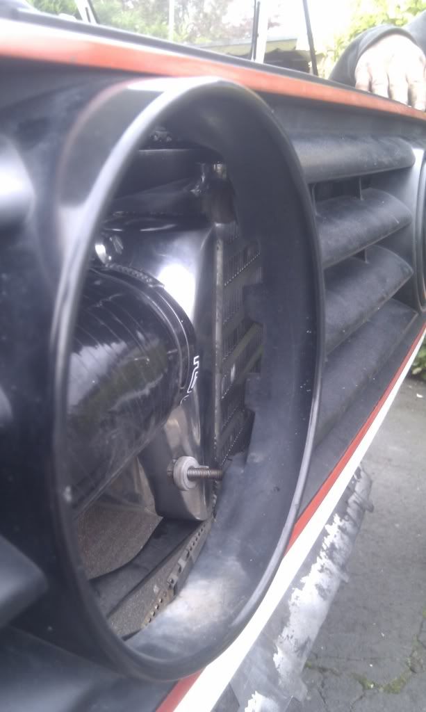

Ok so update on my project so far, this is the intercooler fit, i really wanted to go for the sleeper look as i dont want people to realise it has a G60 dropped in it. So it basicaly looks like a Gti 5dr and i really wanted not to have the intercooler on shw and give the game away, so here we go, let me know you people think  :grin:
So as you can see it is mounted nicely behind the grill and get the maximum airflow through it, however i was unable to fit the grill back on with the spots (which as you can see shows the intercooler off), so plan be was to steal my friends single grill and put that on instead, which i wasnt that bothered about as i have been thinking about doing a single grill conversion, so below is a pic of the new grill on.
So all done, no boost leaks and looking good, let me know what you all thinking. :smiley:

Top job there sir, well done. If you set out for a sleeper look then it's 100% spot on. Also given me some useful pics as i'm replacing my grile and repainting the slam panel.

nice one! the only thing that would bug me would be the wonky intercooler, is there any way it can be straightened up?
Useful for me too! i have slam panel, bumper, both front cross members (rad support & engine support) etc etc to replace!
did the rad stay supported on its own when you removed the slam panel?
Yeah i know what you mean by the intercooler being like that but i couldnt get it mount stright as there wasnt enough room between the slam panel and rad as the rad is at an angle too so it is a really tight fit. I am going to remove these again soon as i want to tidy all the wires and clean up behind there so it is all nice and shiny  :grin:. Maybe if i had a smaller rad then i could possibly mount the intercooler strighter but to be fare not many people can see it which is the whole point.
And yes the rad did stay supported on its own as the hoses and the rad mounts at the bottom held it all in nicly and it was easy to work round.
