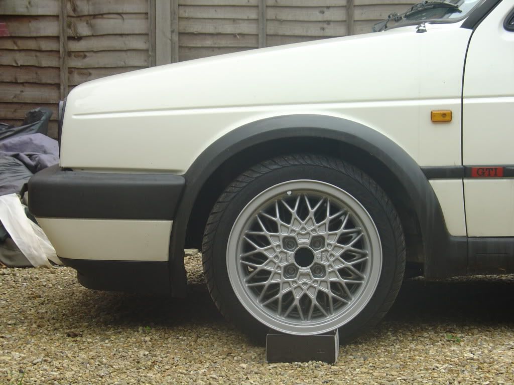

Well I've changed the colour using a Mercedes Brilliant silver as advised and hopefully this will be a nice colour. The lacquer still needs finishing/polishing and i did struggle to get coverage in all the little gaps as much as i would have liked but i think that it had reached the limitations of a diy job as i'll just end up getting a load of runs.
Here's the old colour
Here's the new colour
It's a bit difficult to see in the dull light but i did match the two up and it was a good few shades lighter, actually looked light silver and not grey. Should look even brighter in the sunshine.

There's a few places where the lacquer flooded on the inner spoke edges not too bad but i put this down to never having re-furbed wheels before. Certainly learnt alot and will save the knowledge gained for next time   :smiley:
